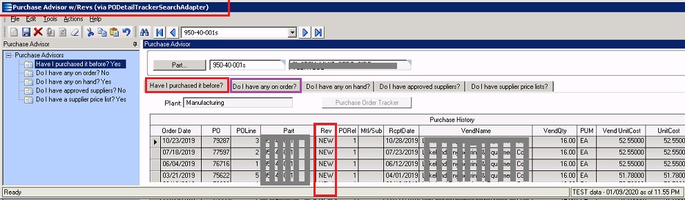

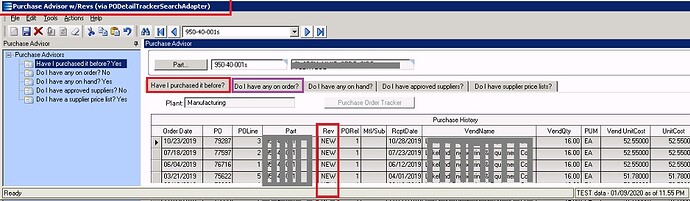

So… ref the attached zip file that includes a PurchAdvisor form with Rev columns
for version V8.03.410, and exported via Customization Maintenance
you will (should) be able to unzip and import back into your system
As I mentioned before…
this is NOT efficient, e.g. the more PO activity you have for a part, the more delay as the “Rev” column is updated in the two grids (PurchasedBefore and OnOrder)
If it was too slow, I might search this site for some publish/subscribe examples, see if one could work in V8?
Ref screenshot

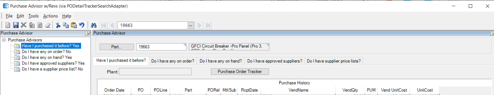

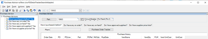

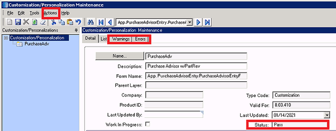

It looks like it imported it, but the rev field is not appearing. At the top of the window though it does show “Purchase Advisor w/ Revs”
Guessing it will be some difference between versions of export source and import target.

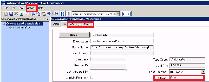

A couple things you could try
Load into Customization Maintenance, see if there are any warnings.

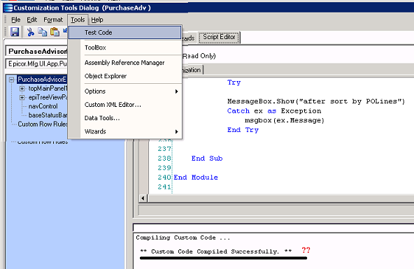

and/or try opening it in developer mode and testing the code - and if the “guids” are correct (match grid properties)
