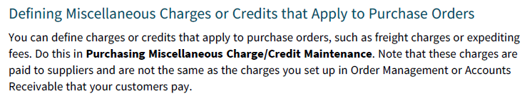

You had me intrigued, so I skimmed the user guide. No surprise, but it’s vague in this regard. The intro does not give me the sense of using them as discounts.

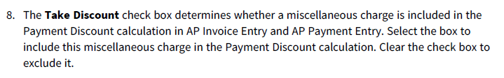

I read the next paragraph (below), and I thought it was saying “use this as a discount.” But I think all it means is, “If you get a discount for early payment (via the payment terms), then also discount the misc charge” (or if false, don’t also discount the charge).
The help on the field seems to spell that out.

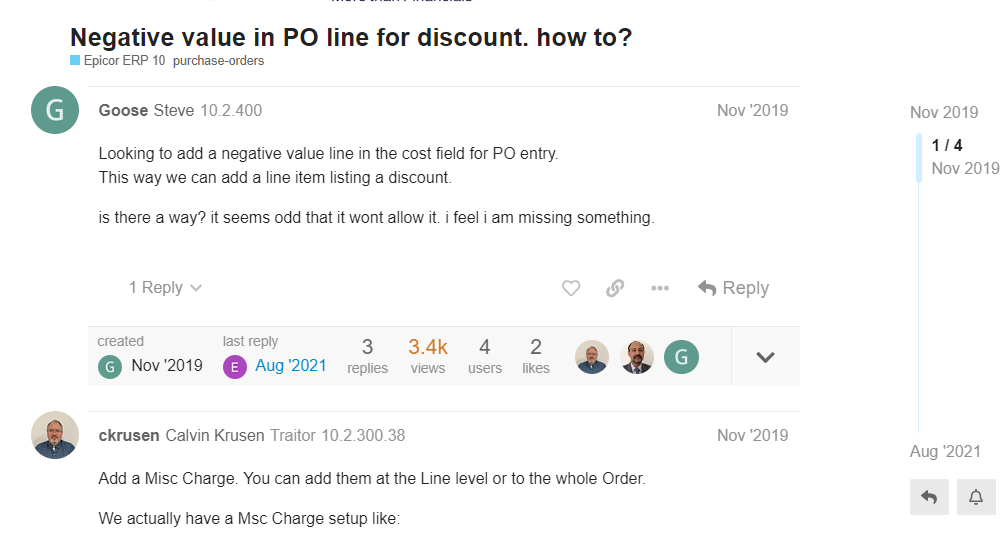

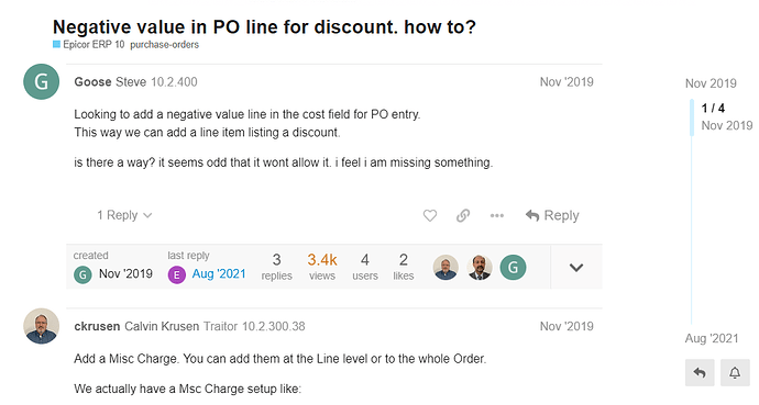

I searched with the question of how to use negative charges and I found this post:
I tried it and it worked so I assumed this was the method everyone used. Once the PO was received however, the misc. charge/discount was not reflected in the receipt not at the AP stage.
