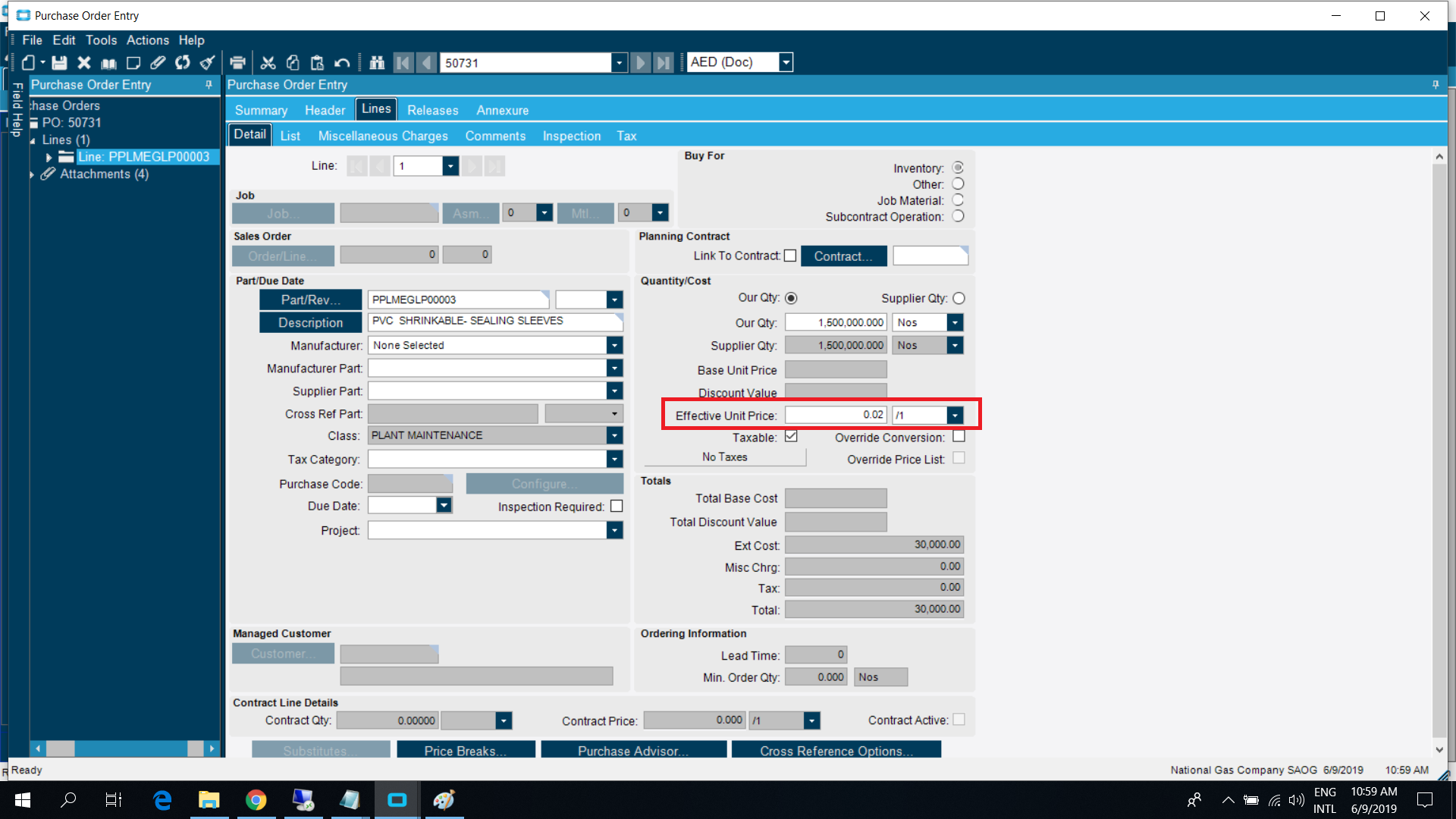

PO line item, Effective Unit Price is taking 2 decimal points (refere to attach screen). We have checked in extended properties it’s already set upto 5 decimal points (refere to attach screen)
Can anyone advise me how to change the effective unit price to 5 decimal points.

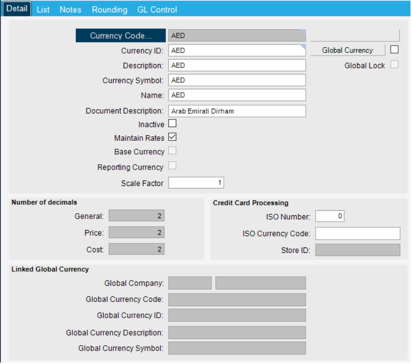

On the currency master, you will find the decimal places information. Many people make the mistake of using 2’s for all of the decimal places. Especially the general decimals where inventory quantities look.

Dear CTCharlie, Please find the below attachment. How to change the decimal places in currency master.
That is the hard part. Once the currency is used, it locks those items in.
EPICOR must have an answer. I told someone else to do a SQL update and change the Currency.GeneralDecimals field to 5. I don’t know how it went.

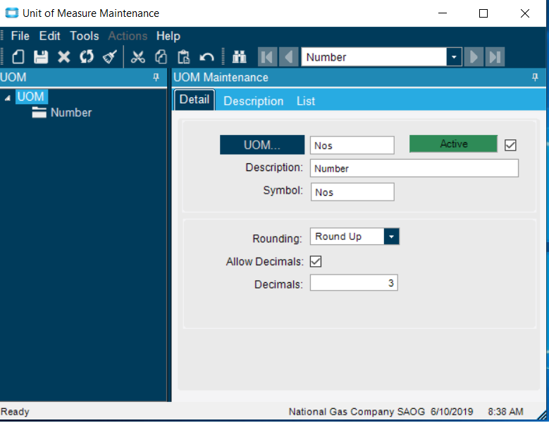

Does that UOM have a number of decimals set?
And you could change the price per from “/1” to “/1000”
$0.01234 / 1 = $12.34 / 1000
Just be careful with any custom PO reports or BAQs. You need to apply that price per factor

Yes, Refer to below screen
dear @ckrusen, if we update the Currency DecimalsGeneral, DecimalsPrice & DecimalsCost using update sql statement (mentioned below) then it will not get worse?
Update Erp.Currency
SET DecimalsGeneral = 3,
DecimalsPrice = 5,
DecimalsCost = 5
Where Company = ‘EPIC01’ and CurrencyCode = ‘AED’
When we had this issue, we called Epicor Support and they did it. Mark Chinsky is the person in the thread who did this before.
One of the other Marks…
@mchinsky, can you please let me know, how to fix this issue.
There is a fix from epicor support. You can increase the decimal places but you cannot decrease.
