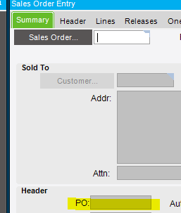

I am able to pull that information. I am using that table. But it’s the PO from here that I need:
Where we’d put the customer’s number.

If you’re just looking for the Customers PO number, that’s on the OrderHead table. (PONum.) But that has nothing to do with YOUR purchase order, that’s the PO that the customer is using to buy from you.
