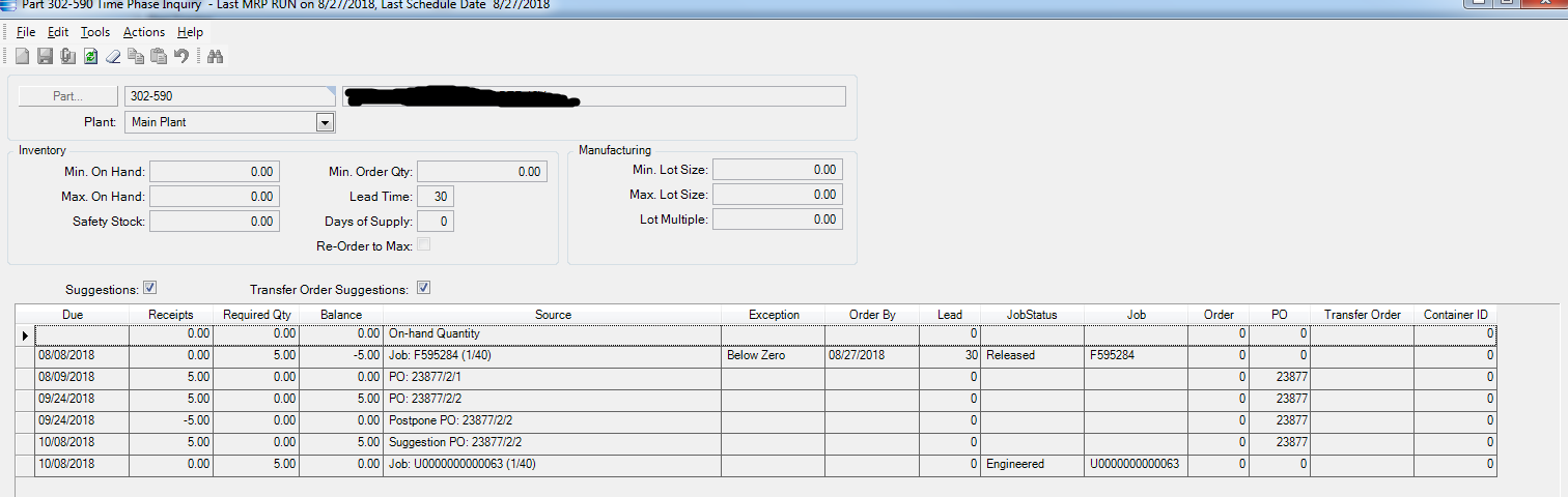

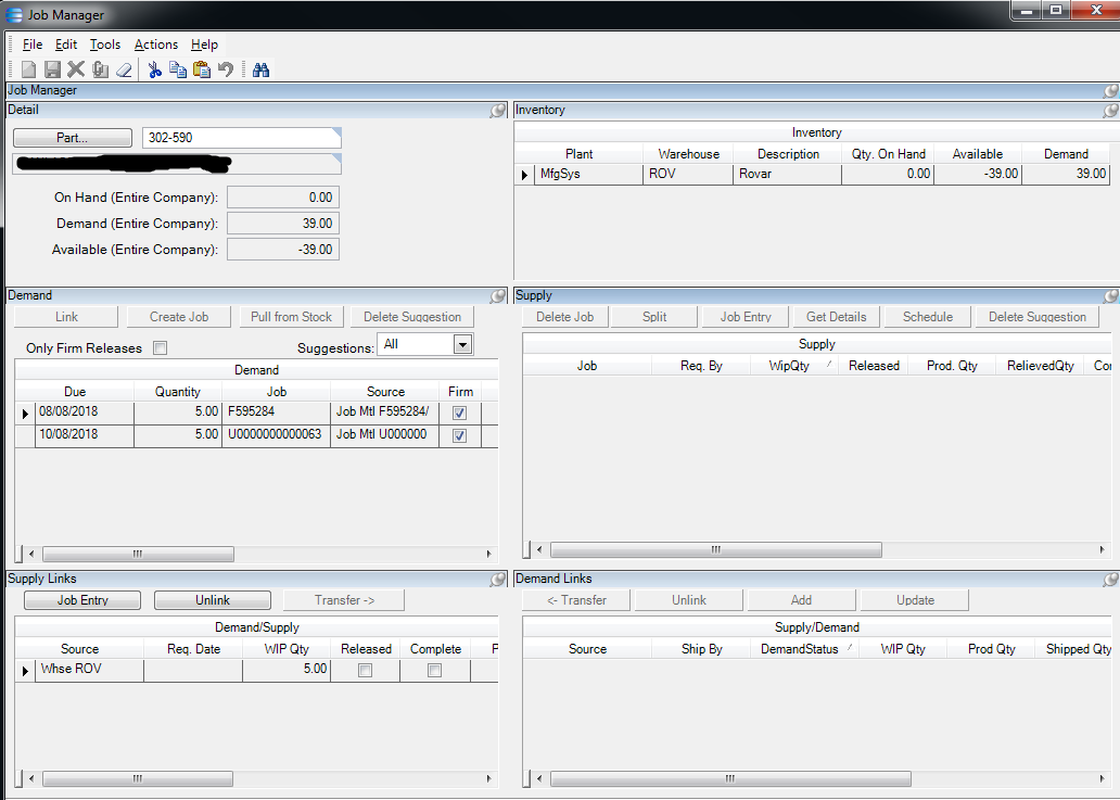

We are running 8.03.405a. We have 2 parts that are showing job demand that is not there. When we look at time phase it only shows a current demand of 10 on 2 different jobs of 5 each. I have tried to find where it is coming from but have had no luck. Job manager dashboard only shows the 2 jobs of 5. There is nothing in the mps, and these parts are not on a sales order anywhere. They are purchase parts that are pull as assembly on the 2 jobs. Any help would be great. We mark all purchase parts as stock items even if we want them to be ordered to the job because we would not see the demand until make direct jobs were firmed up so that is our work around, stock part with 0 for min max and ss stock. But one of the parts in question is a part we hold a stock qty of 20 on. Don’t know if I am making sense or not just trying to give as much detail about this problem as I can. Is there any other way to see where demand is coming from then what I have mentioned above.

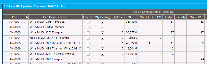

I recently made a dashboard that list all parts, and shows the counts of each demand type (on SO’s, on Jobs, on PO’s etc…)
Note: not all are true “demand”.

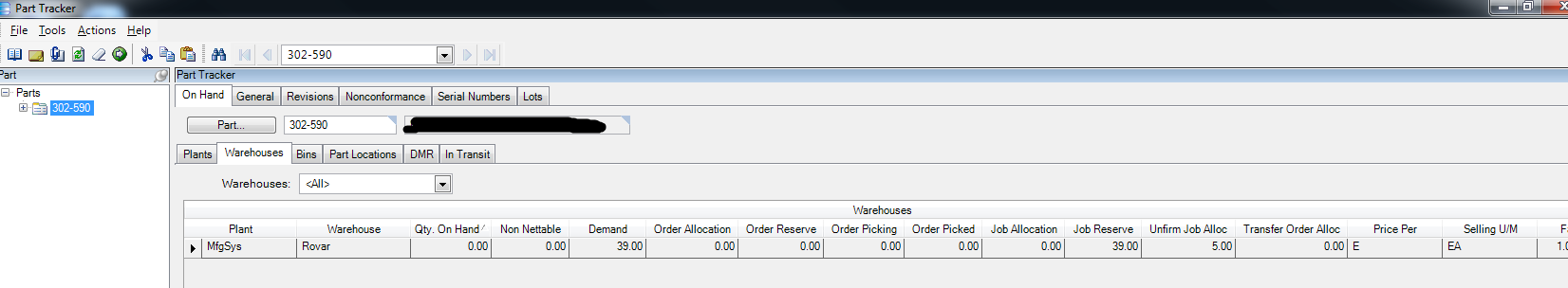

We dont see the demand anywhere other than if we look at the part tracker and go look in warehouse. It never tells us to order or build anything but part tracker will show a negative in the warehouse tab.

Yes everything looks fine. Does not show the 29 extra demand.
I tried the full regen on change po suggestions. These are the only 2 places in the system we see the demand for the part. The 2 jobs for 5 are good jobs but the other is what I am calling ghost demand. There are no purchase suggestions new or change suggestions. Any further ideas.
