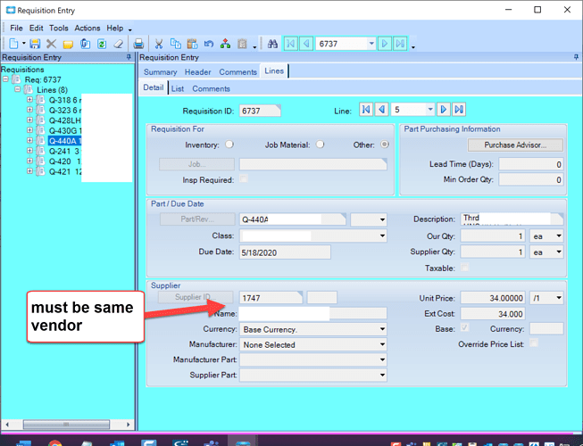

In our version of E10.1.600.20 it works similarly to E9 in that all Requisition lines coming from same vendor get made into a single PO when buy on the multiple lines is selected and generate purchase order for all gets done. I checked to ensure that due date far off didn’t cause new PO in a test, and the requisition below with multiple lines, same vendor, multiple due dates processed all onto one PO at “buy/ generate”. Note, you do NOT need to run generate PO suggestions (nor MRP ) to get the suggestions made for the Requisition lines. They automatically become new PO suggestion at time of “send to purchasing” by Req approver.

I believe the Buyer and Ship Via must be the same as well.
Cross check the below values in the new PO suggestion, all should be same.
  • Terms
  • Buyer ID
  • Ship Via
