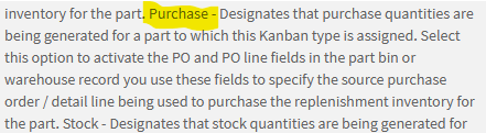

It looks like you need to designate the PO # and PO Line # for them to generate. I guess it is assuming you have a blanket PO to cover it. :man_shrugging:
Ok I was looking at that but it says the field was optional so I was confused. So you can’t just get a normal PO suggestion that you can turn into a PO? Keeping POs open for thousands of parts just to be able to get PO suggestions doesn’t seem very manageable. Anyway I will try filling it in and see what happens.

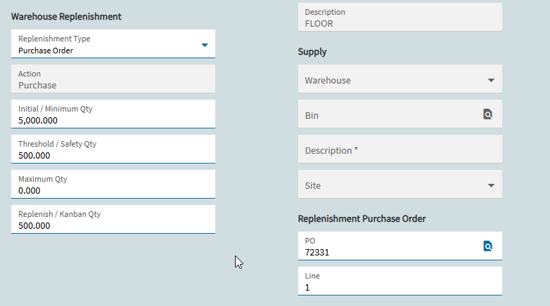

Ok I will see if this works then:
Not sure what I was expecting to happen, but I originally created my PO for a quantity of 10000 with 1 line, no due date. Reran suggestions. It didn’t create any releases or update any due dates on the PO so that doesn’t seem to have worked either. I must still be missing something else.

Change the line qty to 1.
Nope, still nothing.
The only other thing I can think of to try, is to close the release so there is nothing open. :man_shrugging:
