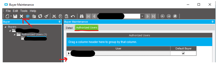

I want our purchasers to still be able to edit due dates of each other’s/pricing in case someone is out of office, so accounting does not have to wait. My main concern is who can approve POs over a limit. Currently the Purchasers can go into PO approval and selected their supervisors name and approve their own PO. Which settings in Buyer Maintenance/User account security/Employee setup do I have to configured in order to achieve this?
From my research, it sounded like I needed to just remove them from each other’s “Authorized Users” list. But this was not the case, and they were then unable to edit due dates,etc.

You need to restrict the access (Authorized User) to the Approver Buyer(s) and not on the regular Buyer(s).

Correct, currently I have on there the supervisor listed as the only Authorized User on each of the Buyer’s accounts.
However, doesn’t that mean now that the regular buyers won’t be able to edit each other’s POs? I mainly want to restrict them from being able to select the supervisors name and authorize a purchase themselves without it being sent to the supervisor for approval.

They can be approved users of each other… but, as long as they’re not approved users of the supervisor, they shouldn’t be able to approve in his/her name. At least that’s my understanding.
So, if Buyers A and B are regular Buyers… and Buyer C is the supervisor…
I would give A & B rights (authorized buyer privileges) under each other, but NOT under Buyer C.
I see your point, though… that if Buyer C (the supervisor) has POs out there that need edited, Buyers A & B won’t be able to make changes. But that’s just the nature of the beast, unfortunately.

Correct. My understanding too. They have to be an approver of the manager too.

If the Buyers are authorized users on the Supervisors account, they would be able to create POs for the Supervisor limit.
