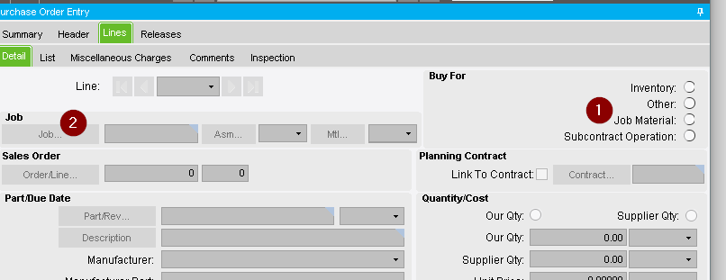

If a job contains a part that is not in the system (or is purchased AND not Qty Bearing), it becomes a “Buy To Job” (BTJ) part. When entering the PO, select “Job Material” in the Buy For area of the line detail. Then enter the Job Num, Asy, and Mtl.
I can’t help with how purchases via a CC are handled, as we don’t do that.
When the part is received, its cost will go straight to WIP. The Job Num selected during PO entry will be used for tracking the cost. There is no tracking of the part except for the cost and the job. You should tage the item with the job number and move it to production (or some “Bought For Job” holding area). The system does not track qty’s of BTJ items received.
If you have two jobs that use the same part, you’ll need to create separate PO lines (one for each job).
