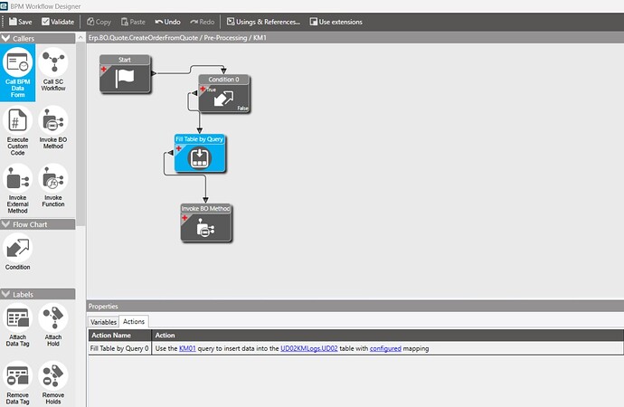

Erp.BO.Quote.CreateOrderFromQuote
Pre Processing
Condition
The
dsQuoteDtlRow.UDField<System.String>(“ExtraComments_c”) == null
expression is invalid
True = Fill Table by Query
ds.QuoteDtl.Company = Erp.QuoteDtl.Company
ds.QuoteDtl.QuoteNum = Erp.QuoteDtl.QuoteNum
Display Fields
all of the above plus
ds.QuoteDtl.ExtraComments_c
Erp.QuoteDtl.ExtraComments_c
Fill Table by Query:

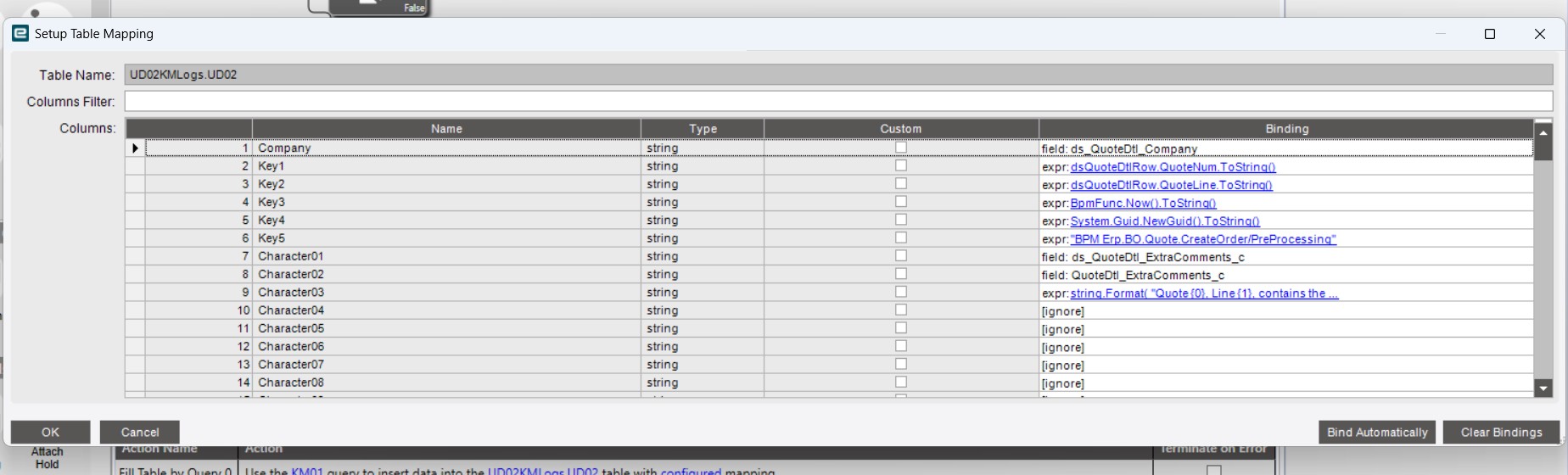

Use the KM01 Query to insert data into the UD02KMLogs.UD02table with configured mapping

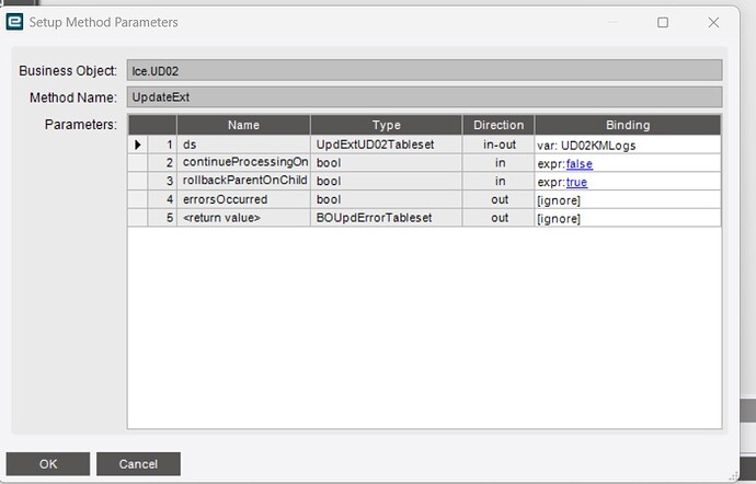

Invoke IceUD02.UpdateExt BO Method with configured parameters (see screenshot)

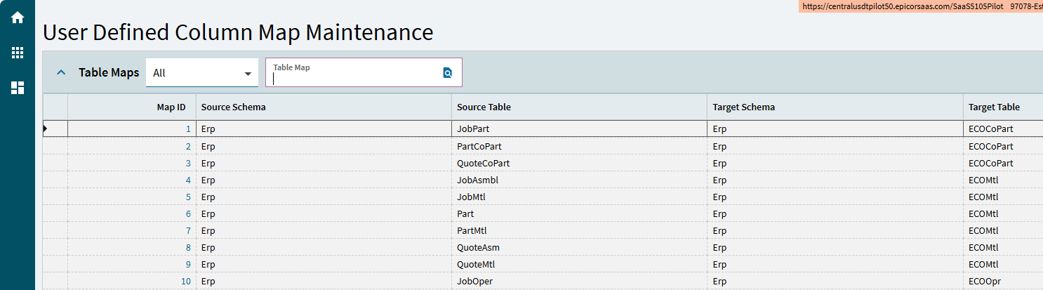

Check out UD Column Mapping. It’s a bit to wrap your head around, but you might not need the directive route.
Joe
Hi Joe,
I saw that but didnt see a QuoteLine to SO Line mapping or how to add one…
