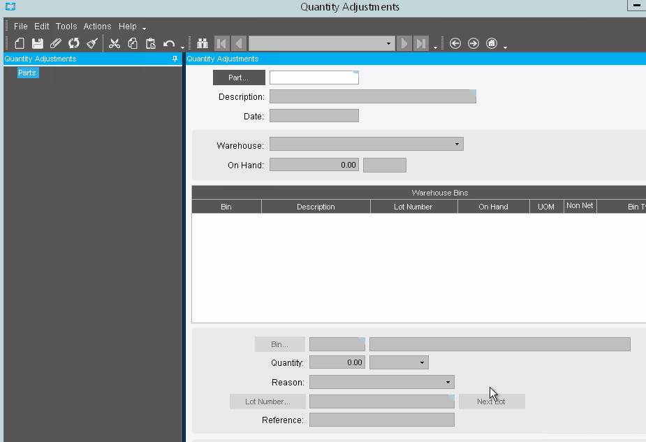

There a transaction log in the qty adjustment screen. See if that works (if they have access to the screen).

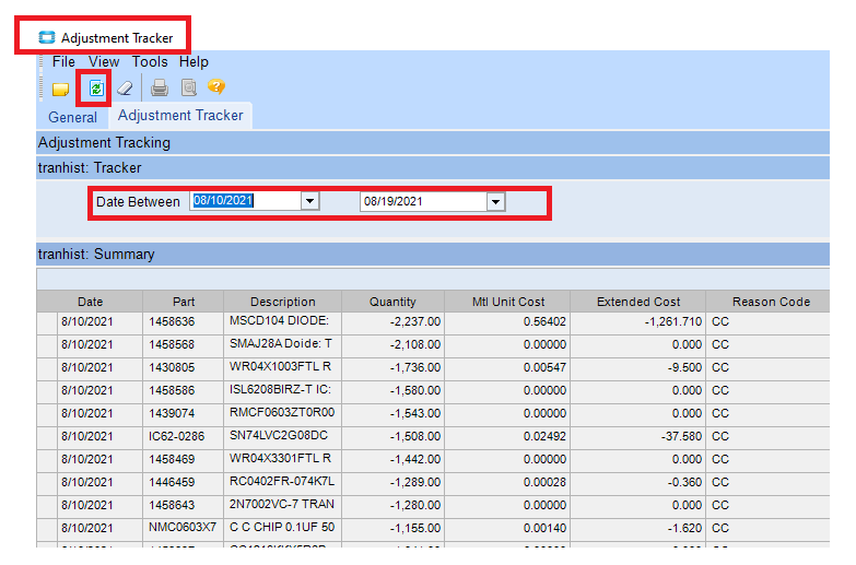

Also we have this display…
