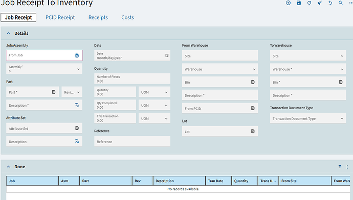

Another option might be Job Receipt to Inventory.
We use the Job Receipt to Inventory (moving CoParts back into inventory), there is a cost tab that helps with the costs portion.

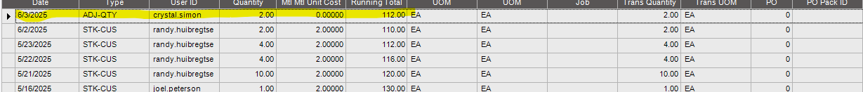

Hello Beth,
This happens every time we inventory adjust quantity in the system. I attached a picture as an example. You can see it has a cost associated with the previous transaction. I am not sure how to get that cost to transfer over to the quantity adjusted transaction. If it is because we use last cost and the only fix is to manually go in and adjust the cost each time, we may have to consider switch despite the amount of work it would take.

It appears that Epicor has changed something in its upgrades. In 2025.1, I made a Quantity Adjustment for a part with a Costing Method of Last and the transaction, ADJ-QTY, was made at the Last Cost from the Part Cost.
