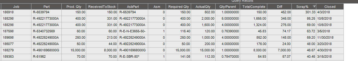

**You can see in the first image the query calculates just fine. **

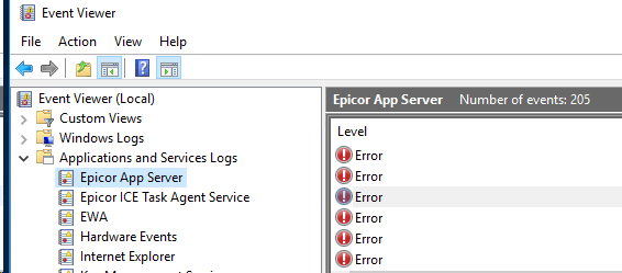

What does it say in the Event log for the error details?
Pierre
How do i look up the event log on baqs?
It is on the server side, under Event viewer
