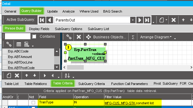

I made an Inner Sub Query that sums up the Qty’s of the parents leaving WIP. Basically, the MFG-STK and MFG-CUS trans

The table criteria for JobMtl_Net was just to limit the data returned for testing. You might want to include the criteria: IssuedQty <> 0 no reason to do math on those records.
