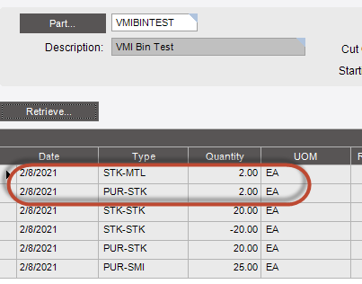

I was curious about this so I did some testing in a Dev environment. Backflush doesnt appear to pull from a SMI bin. You can do a manual material issue from a SMI bin though. When you do, it does a PUR-STK transaction followed by a STK-MTL transaction.
