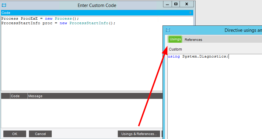

Not that I’m encouraging calling an .exe in a BPM,
but should you be including something like this after your code:
Process.Start(proc);
That’s how I tested calling an exe from a button (after searching on here)
Example:
