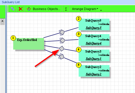

I started with a first level with ‘OrderHed’ and the subquerys (InvHed, Customer, Part, ShipHed and ShipDtl). Then I used the ‘SubQuery Critera’ but with that I can’t display the fields of the subquerys.
I tried then to do the subquerys directly on the first query level and with the ‘table relations’ I was able to display all fields of my interest.

The tables related to OrderHed should use Outer joins (All rows from OrderHed ). That way an OrderHed without any Invoices will still show.

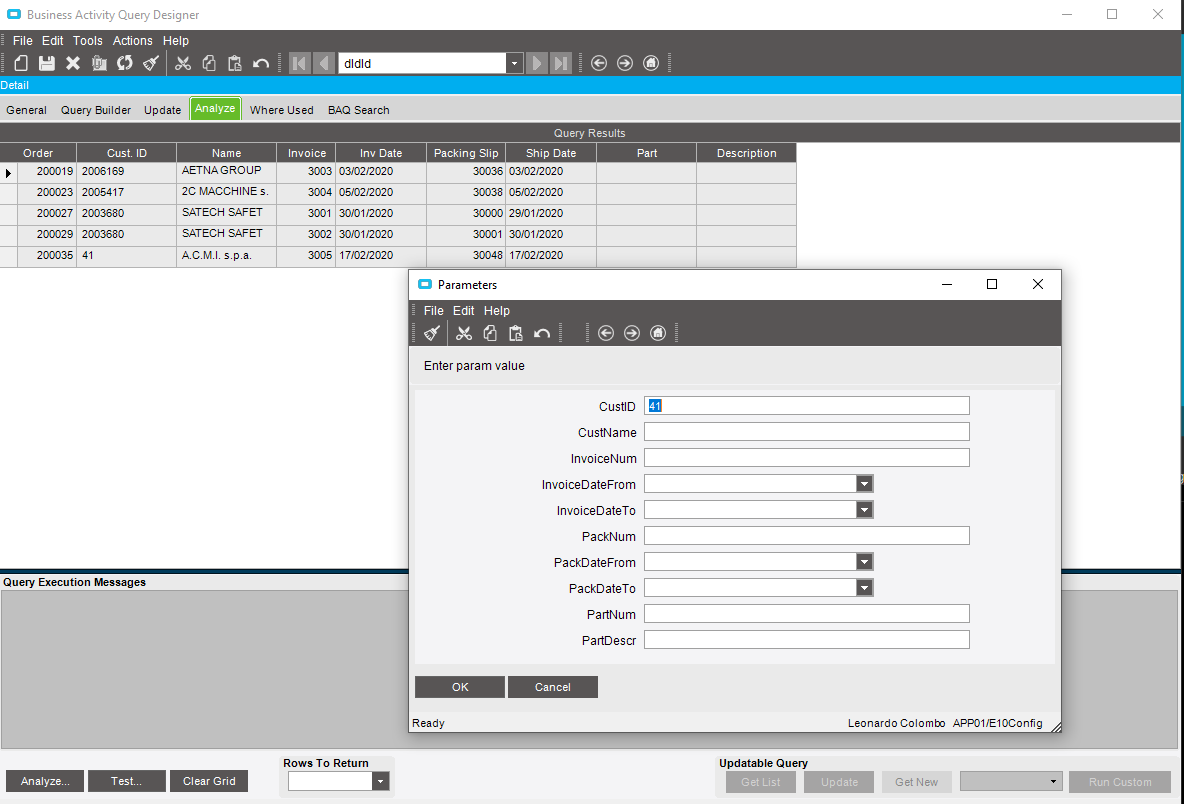

For example I selected the CustID 41 but I have rows for Customer that are not the 41.
I’ll upload the BAQ so you can see what I’m talinkg aboutdldld.baq (67.8 KB)

Also, Did you mean to make the OrderHed to subquery3 sub query an inner join?

I tried already to check ‘Skip Condition is Empty’ on all the parameters but then I can’t use the parameter as an expression…It vanish from the ‘Parameters’ section when selecting ‘specified expression’.

Another issue you’re going to run into, is that while you can set the Param for InvcNum as “Skip condition …”, that won’t work, because the parameter for field defaults to 0 even when left blank.
