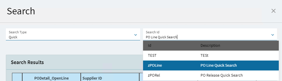

Hi, I have created a Quick Search in Kinetic. When I click on the search the search grid is populating with values and when I select a value and click Ok . The value is not getting add to the field and Quick Search slider is also not getting closed.
Is there any one come through the same issue?
If any one have the solution for this issue? please suggest.
I have a similar problem with POLine Search on Receipt Entry Form.
  1. When I right Click poLine → Quick Search Entry Create my Quick Search And mark it as Shared and All Occurences the Quick Search is not available in the List.
  2. When I do the Same from PoRelnum from receipt entry Screen the Quick Search Shows in the list But the context Key(Like) field is taken as POHeader.PONum.
  3. The System Quick search also does not populate if selected any Value
Am I running into a Bug Here or I am missing something which is important related to quick search.
