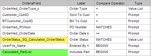

When I build the QuickSearch, I specify the various criteria. The parts field shows as “Calculated_PartList”, but the status field defaults to “OrderStatus_SQ_Calculated_OrderStatus”. If I try to save the QS like this, I get an error which states “The table/field is not valid.” To fix this, I simply re-select Calculated_OrderStatus from the Criteria Column drop-down and the record can then be saved. My problem is that that when I pull up the QS again, it reverts back to it’s previous state as shown here:
As stated earlier, in order to save the QS, I have to re-select Calculated_OrderStatus.
When attempting to use the QuickSearch, I can specify a Part and get the expected results. When specifying an Order Status, however, I always get ALL orders. My guess is that the whereClause is ending up blank somehow. Curiously, if I use Actions > Test Quick Search, it works perfectly.

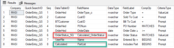

When looking at the SQL data in Ice.QuickSearchCriteria, the columns appear as shown here:
Note that I’ve place a red box around the subquery value which does not work correctly, and a green box around the subquery value which does work.
BTW, I did see a post where someone resolved this by directly editing the SQL data, but this is not an option at my company for data integrity reasons.
