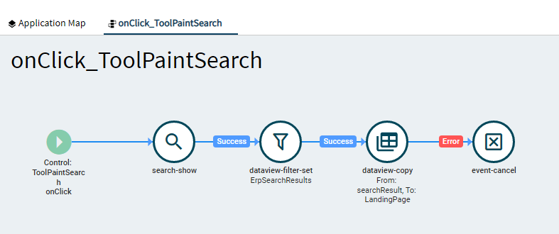

I added a custom paint icon on the Landing Page toolbar, and created the onClick event to load the QuickSearch when the icon is clicked.

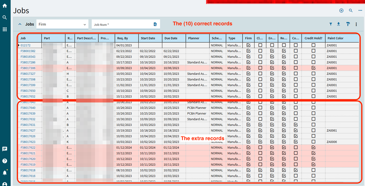

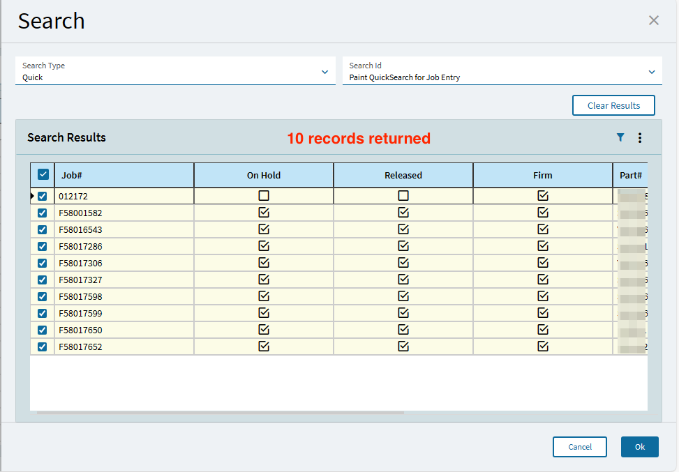

This all works perfectly. The search returns the correct results. However when all of the results are selected in the search panel and I click OK to load them into the Landing Page grid, extra records are showing and I can’t figure out why.

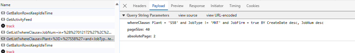

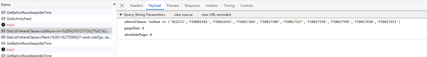

In debug mode, I see the call to my custom search, execution of the BAQ, and the results (10 records). When all of the records are selected OK is clicked, there are TWO calls being made to GetList. The first one is filtering for the records I selected in the results and returns the correct dataset. Then ANOTHER GetList fires and returns all of the extra records I’m seeing in the grid.
I guess I don’t understand why GetList is being called twice. There must be a default or something that I’m missing. Any help is greatly appreciated.
Search Results
Search Results in Landing Page
GetList 1 & 2
onClick Event

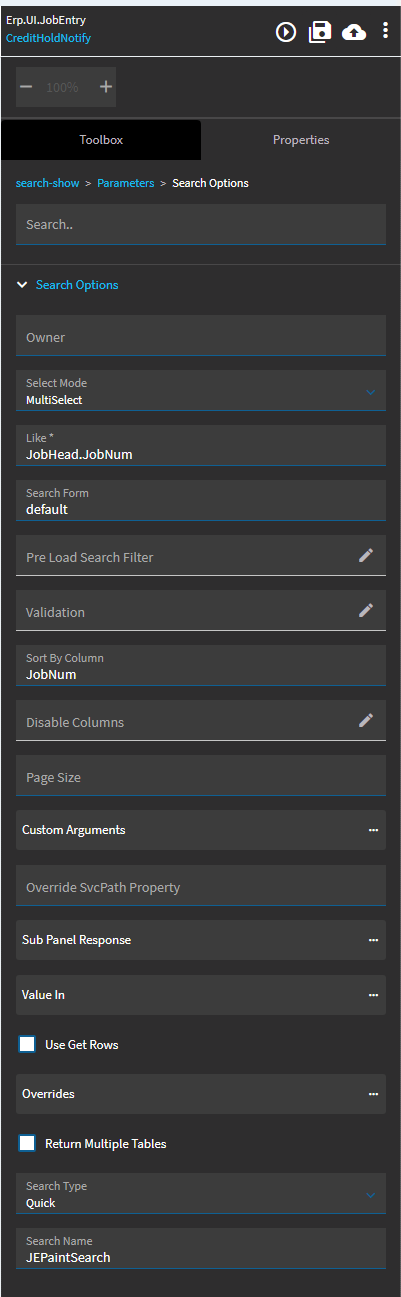

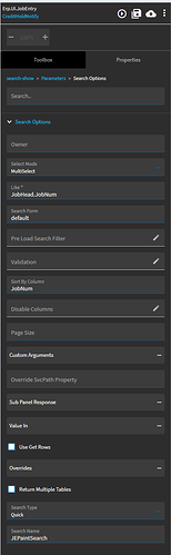

search-show props

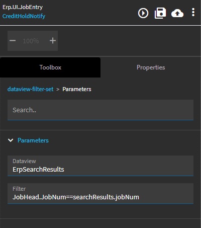

dataview-filter-set
data-view-filter-set

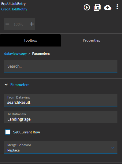

dataview-copy
Turns out you don’t need to re-invent the wheel! Who knew?!?
The solution was to remove dataview-filter-set and everything after it. Select search-show, set OnSuccess = event-next, Event = Execute_Search_onSuccess. This is the event that runs after a built-in search. Works a treat!
