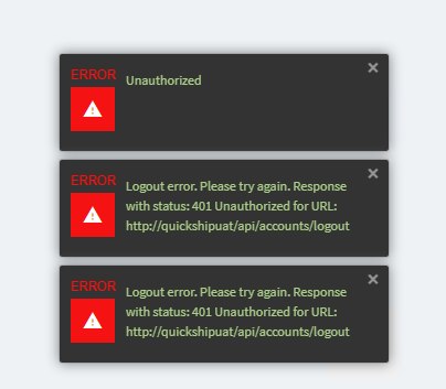

I’ve not used Quick Ship so I don’t have much to offer apart from the URL…. It seems to refer to UAT, so maybe it’s similar to UK tax reporting where there is a checkbox to tell it to run in sandbox mode, or the update just overwrote the URL.

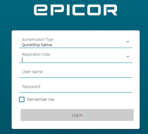

Thinking it would explain bad credentials warning and the missing registration code?
@Chris_Conn The auto did not work for me tonight, so I went with the upgrade process in the QS 2023.2 Upgrade Guide. There are some new ,Net requirements and I had to logon to the desktop shortcut on the server first. Then I still got some errors like yours on my PC, but they cleared after I cleared my browsers cache.
