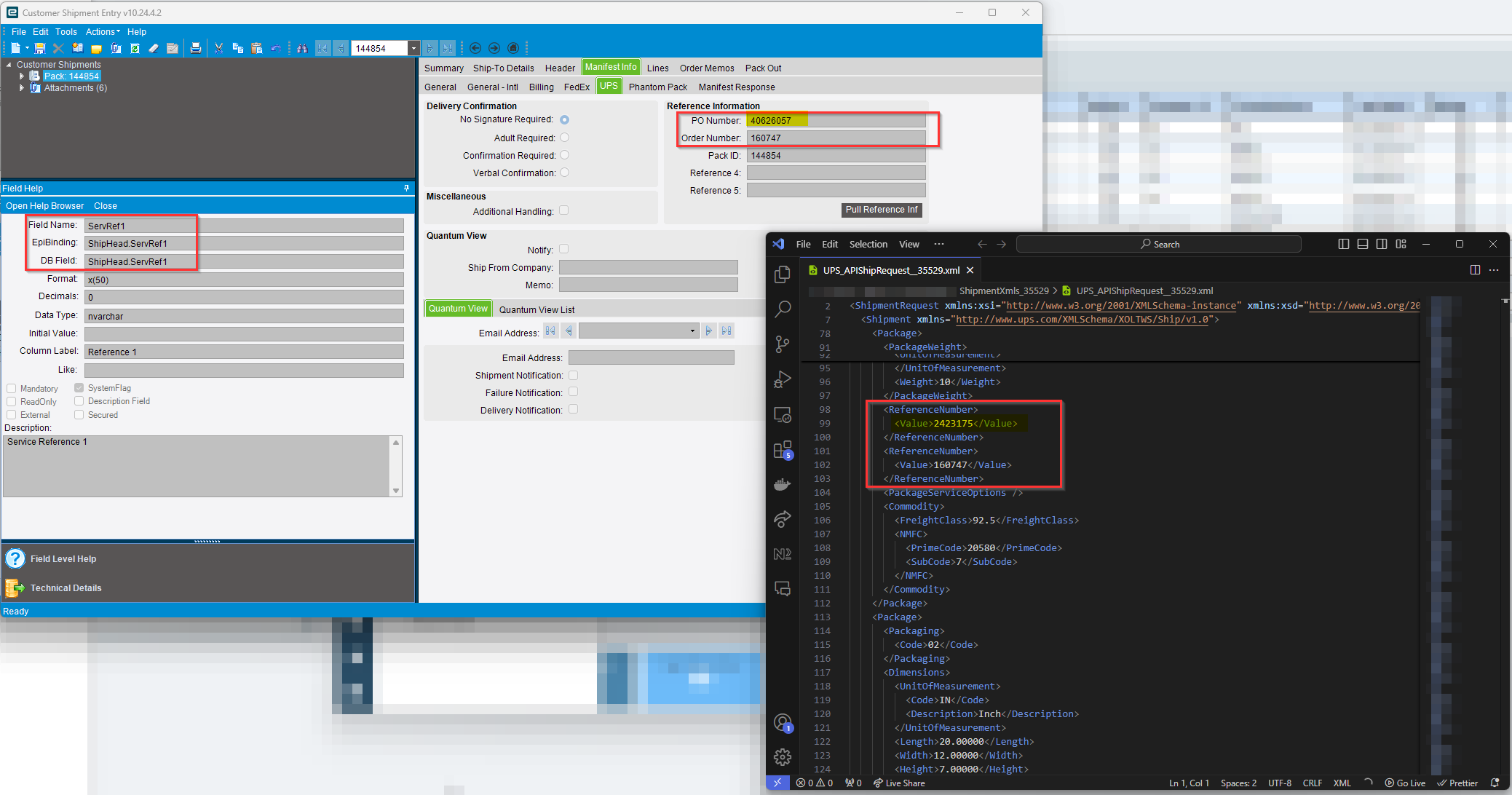

Is it wrong in the Epicor request and the shipment request or does it get changed before the UPS request?

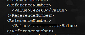

The correct value is show in the request to QuickShip. Sorry I should have included that request initially

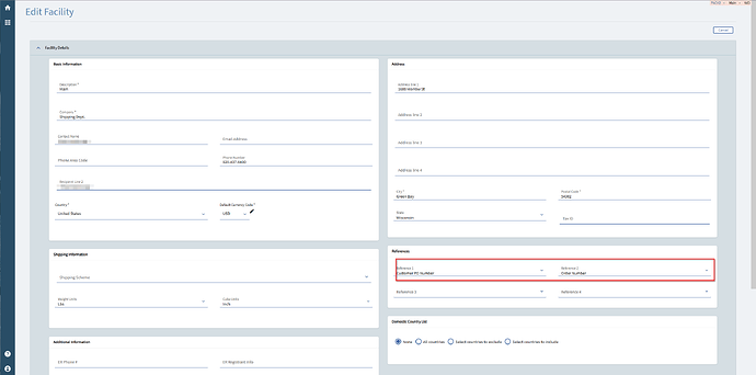

@gpayne in facility maint in quickship what do you show here for references? I have a configuration there, I’m guessing you do not.

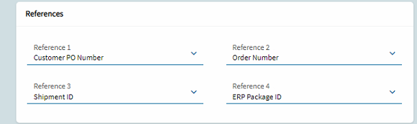

@jgiese.wci we just went through the setups with the Quickship team for cloud migration, they has us configure the facilities like this:
@jgiese.wci I have them also and with no info in the reference fields in shipments they are there, but Order Number is ref1 and PO is ref2

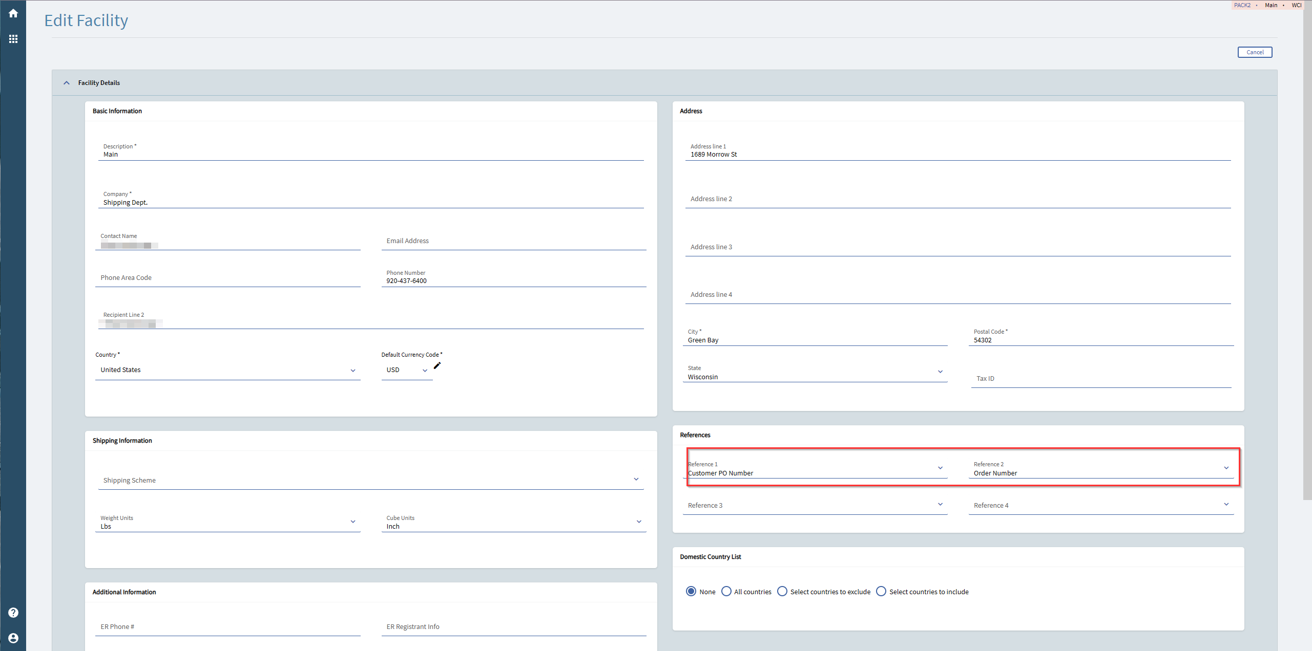

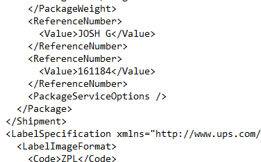

I ran several tests and found that when my facility has those reference values entered it does not override like others have demonstrated. Not sure if that’s version specific? By removing the configuration entirely I was able to override what QuickShip was sending to Epicor. Prior to removing the configurations I got the PO Number and Order Number no matter what in the UPSRequest.xml
