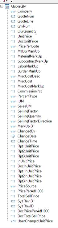

Hi, where can I find the Unit Cost, as the QuoteQty field does not include it?
Welcome @kynthhh !

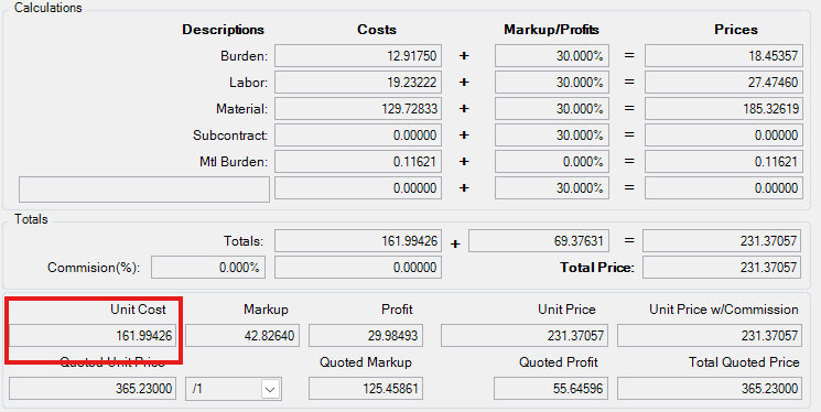

That is the calculated unit cost that the worksheet calculated based off of your quote method. I would use the Field Help to see where it is stored.
Hi @jkane ,

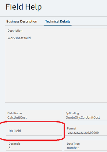

I’ve already used the field help, but I can’t find the calcUnitCost or totalCost in the QuoteQty table.
Just took a quick look at the list of quote tables and I do not think that is stored anywhere. I believe it gets calculated only on screen.

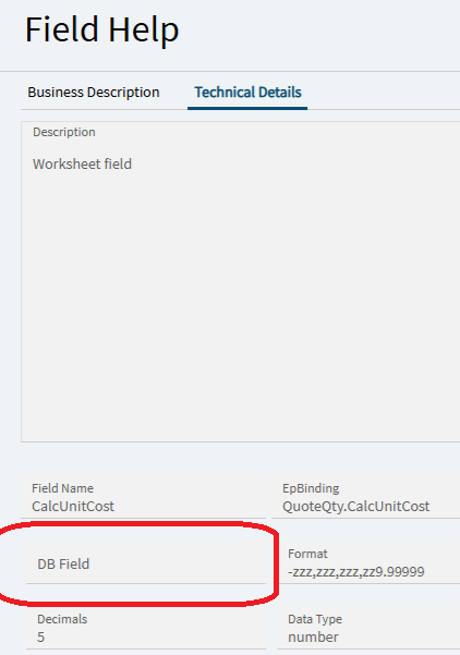

I’ve looked through every table but couldn’t find it. Thank you
When this area of the Field Help is empty, it confirms what @jkane says above in that the value is derived on the screen and not stored in the database.
