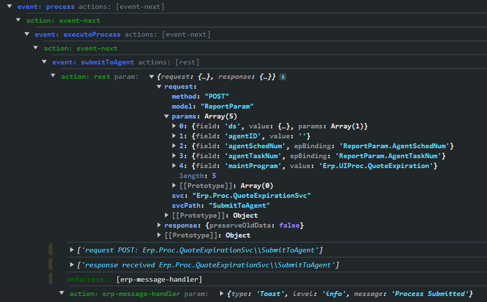

Doesn’t the Process Quote Expiration process mark quotes as lost if they’ve met their expiration date without a sales order drawn down against them?
I didn’t even know there was such a process. Gonna have to look into that one.
Just ran this process in my Pilot database… didn’t seem to do anything. Process started and ended instantly. Almost seems like its unplugged. I’ll have to explore that more later.

@Ernie can you (or anybody) confirm anything happens if you run this process?
Again, it seems to do nothing. No quotes were closed as lost when I run it. Not sure if I’m missing a checkbox somewhere to apply this process or not.
The process runs:
System Monitor shows “COMPLETE”… but doesn’t seem to actually DO anything (impact any records).

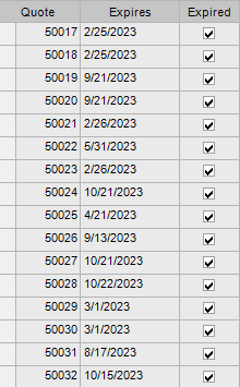

It checks the QuoteHed.Expired flag as false or true depending on the condition of the quote, whether it meets expiration or not.
Gotcha! Thanks @utaylor.
Can verify that appears to work at least.
But it does NOT appear to set the quotes as “Lost”.
