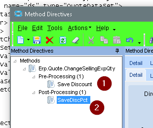

The following appears to work:
Two Method Directives as shown below
Method #1 (the Pre-Proc)
Set the UD field to the current DiscPct. Note that I didn’t add a UD field, but just used the field Rpt1Discount. You should add the UD field and use that
Method #2 (the Post- Proc)
Set the DiscPct field to the UD field’s value. (agin I just used Rpt1Disc in my example, you should use a UD field)
Note that both of those methods are required

pre Processing on: Erp.Quote.ChangeSellingExpQty
set new UD field to store QuoteDtl.Discount, yes this works
set new UD field to store QuoteDtl.DiscountPercent, yes this works
Post Processing on on: Erp.Quote.ChangeSellingExpQty
set QuoteDtl.Discount to equal the new QuoteDtl Discount UD field, No not working, stays wiped at 0.00
set QuoteDtl.DiscountPercent to equal the new QuoteDtl Discount PercentUD field, yes working.

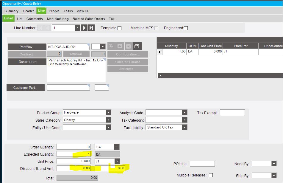

If you save the line with the mismatching DiscPct and Disc, and then refresh, does it then show the proper discount?
It does when I first enter a discount %
The discount amount is 0.00 until I save
If I then change the expected selling qty, the discount % now remains in place (e.g. 10%) but the discount amount reverts to 0.00, and save/refresh does not pull in the correct amount, or any change at all, it stays at 0.00
so I have discount 10%, but discount amount 0.00

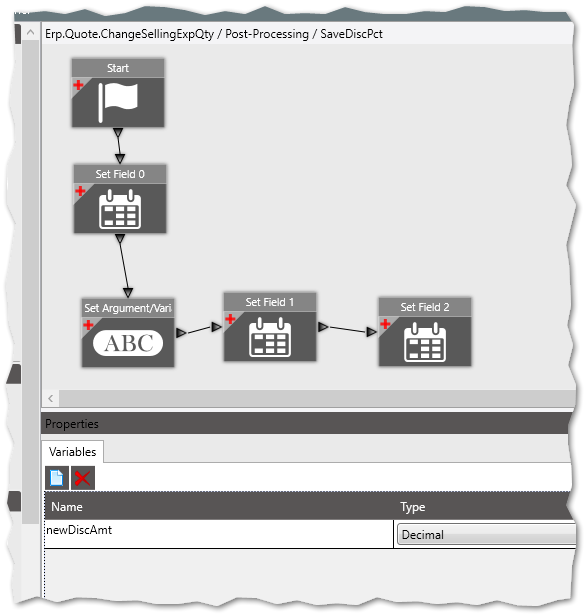

@KMenz -
It works for me when I do the following in the post-proc
  1. Set Field 0: Set the ttQuoteDtl.DiscountPercent field to the UD field from the pre-proc
  2. Set Atguemnet/Var: Set the variable newDiscAmt to
    ttQuoteDtlRow.Rpt1Discount * ttQuoteDtlRow.SellingExpectedQty /100
  3. Set Field 1: Set the ttQuoteDtl.Discount field to the variable newDiscAmt
  4. Set Field 2: Set the ttQuoteDtl.DocDiscount field to the variable newDiscAmt
QuoteKeepDisc
EDIT
Step 2 is missing the unit price, and uses RptDiscount1 for my test when the UD field is what should be used.
