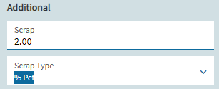

Even the jobasmbl one? There is a field for the asm scrap in engineering workbench
Yes, even the jobasmbl, but you can’t use it, it’s a “system” field.
Sorry to keep on pestering you, but what happens if you enter something on the MOM? Does it just ignore it? I can test too if you can’t.
Just ignores it. I added a numeric editor to the quote screen and bound it to QuoteAsm.EstScrap and put a number in there… the required quantity was not affected…
On JobAsmbl I couldn’t use the field as it was read only.
It’s not a used field anymore and probably shouldn’t exist.
You can enter a value in Engineering Workbench.
