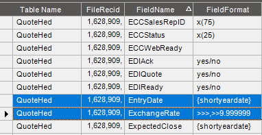

I do see that there is a QuoteCSR nvarchar field on QuoteHed, which is not always the person who entered the quote.
Try EntryPerson
AFAIK this is not there for Quotes…?
It’s showing in the Data Dictionary viewer
That’s what I thought too @jkane
Not in my version must have been added later for parity with Orders.
Is it possible there is an expectation the it’s the primary sales person who enters the quote?
it’s there in 2024.2
Depends then on which version you look in :slight_smile:
Yeah I was just checking my 2024.2 system and it is in that system.
