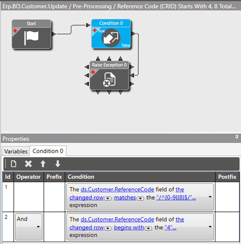

I have 3 Pre-Processing methods on Erp.BO.Customer.Update. 2 out of the 3 do a RegEx condition match for a Name field: “[^0-9()*#+]$” and a Reference Code:
and the last one does a validation check for email containing an “@” and “.”
I am able to get the errors working sometimes, for example the Reference Code throws the exception box the first time I input the numbers incorrectly, however when I input a “4” at the start and the correct number of digits (8) it should move to the next method but it doesn’t.
The below screenshot highlights my 3 method directives. I am unsure of how the order field and enabled checkbox work so I gave “Character Check” 30, “Reference Code (CRID)” 35, and “Email Contains @ and .” 40 and ticked enabled on all of them. I am unsure if this has anything to do with the sequencing of when the methods fire, in which order and if I’m missing something in the BPM to proceed once one method has been validated.
Ideally I would like the form to be filled out (incorrectly) and the validations to get raised one by one until they are all complete, I just don’t know what I’m doing wrong or if there’s a better to way approach this.
If more information is needed let me know and any help would be really appreciated!
I don’t believe you need that beginning and end slashes. Try just
^[0-9]{8}$
Without the beginning and end slashes. In C# you don’t use those.
Thank you! that resolved the RegEx for the reference code. The RegEx for the name validation however isn’t working even though I removed the slashes and contained numeric values 0-9 and special characters I want matched *#+()
It throws another error relating to another field and completely skips the name validation error I need thrown. Is there something I am missing I’ve tried multiple combinations (added + to the end before the $ symbol) and checked the condition widgets and they are all correct.

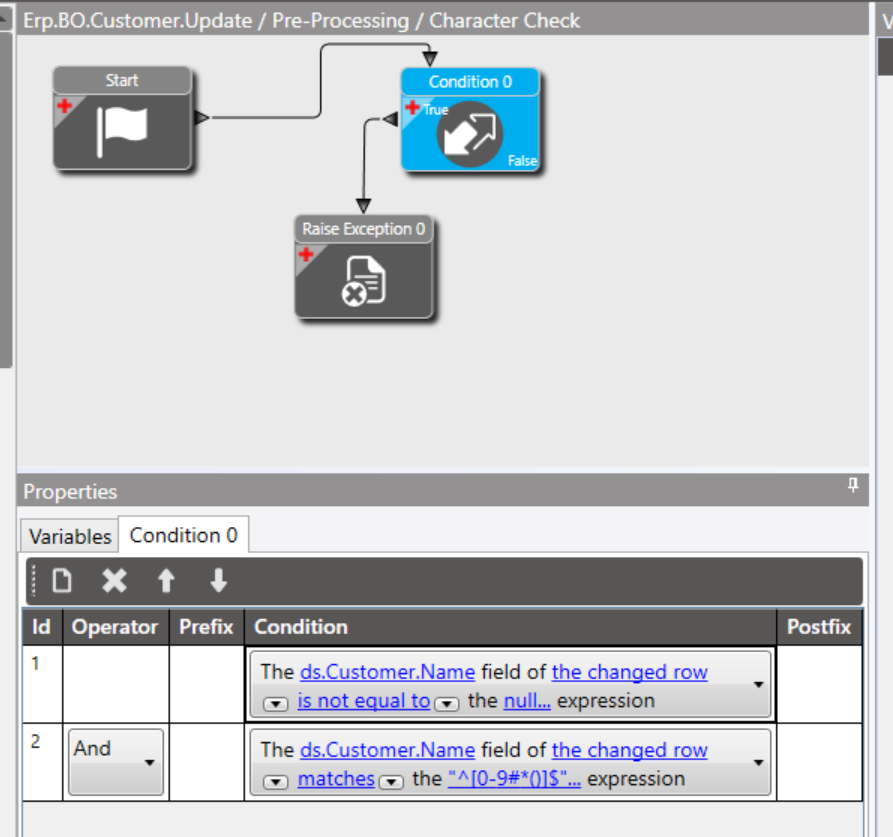

Name field - if not null, cannot contain numbers, or these special characters # * ( ) → at the moment I’ve got it throwing an error when ONLY special characters are present, I need it to match any of those numbers or special characters when a user inputs their name.

Okay so it goes something like this, just for the Name field for example:
I have set the conditions if the Name field is != null and it matches my regex expression it will throw the exception.
I have input characters that match the Regex expression and it hasn’t registered the exception and skipped over that BPM to my next method directive BPM error message. It should be raising my Name error message. Am I missing something? does the expression null not apply, should it be an empty string “”?
Is your Name condition the first in the BPM order?
There are 3 already made BPM’s that are infront, I did not make those ones, as far as my BPM’s are concerned Name is Order: 30, then the Reference Code (the CRID error message bpm you see above) is Order: 35, then the Email field containing @ and . is Order: 40.
Does the logic look correct?
Show the expression.

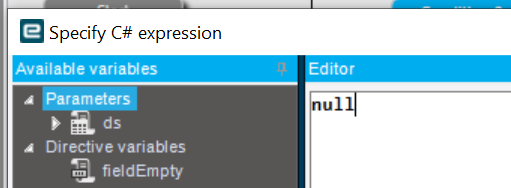

null is its own nullable reference type right? C# should identify that on its own.
Regex on the other expression for your reference to:
I didn’t set any variables I just used the expression editor on the actions tab
That second one will not work like that.

I’m really confused around the not null action as these fields can be left empty if the user doesn’t have the information to provide which is fine, but as it stands my validation doesn’t allow them to be empty because I’ve messed up the != null action.
