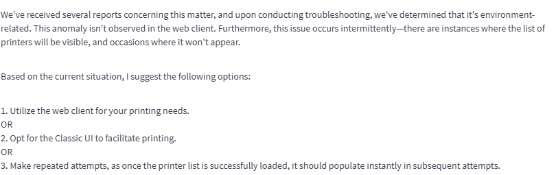

We’re on prem converting to kinetic. When trying to print to a client printer the printer just spins and spins. I opened a support ticket and this was their response.
Yes, I can see the printers on the web, but my users currently use the client version. Telling them to just keep trying is mind boggling. :sob:

That’s the same response we got from Support on this issue years ago. They never seemed interested in resolving it.
