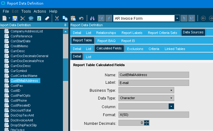

Does anyone know what field the InvcHead.Calc_CustEmailAddress is coming from (on the report styles)? Maybe @Rich? Thanks for the help!

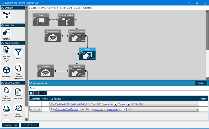

By default it will use the Bill To customer email address.
If “Print Sold To Address” is marked it will look for the primary billing contact of the Sold To Customer.
If not it will check if the primary billing contact number is populated and use it.
