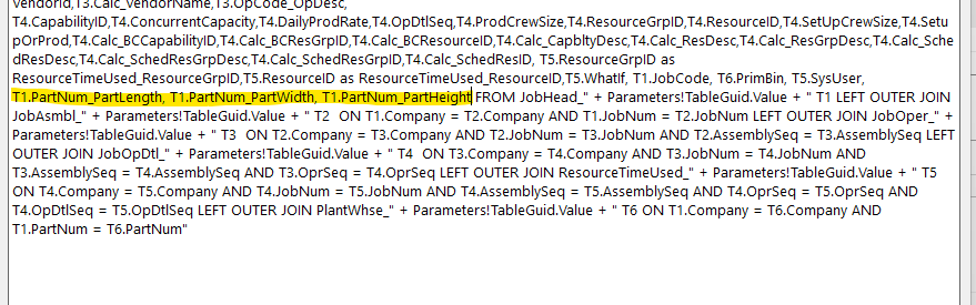

I’m working on a job traveler report. We want to add some Part Attributes to the traveler for QC purposes. It started easy enough. I added the Pick Link ‘PartNum’ then added the fields ‘PartLength’, ‘PartWidth’, & ‘PartHeight’ to the picked side and saved.
I then added the fields to the query for that data set in Report Builder using the syntax T1.PartNum_PartLength and so on for the other fields.

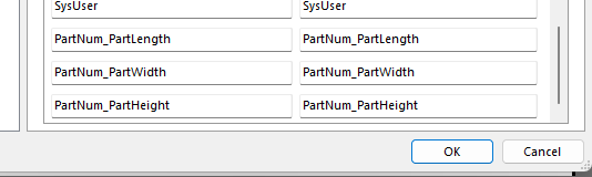

I added the fields in the data set properties.
When I try to run the report I get the error the PartWidth and PartHeight columns are invalid but the PartLength column is fine. If I only add the PartLength field the report runs fine. I can’t find a difference anywhere in either the RDD or the report.

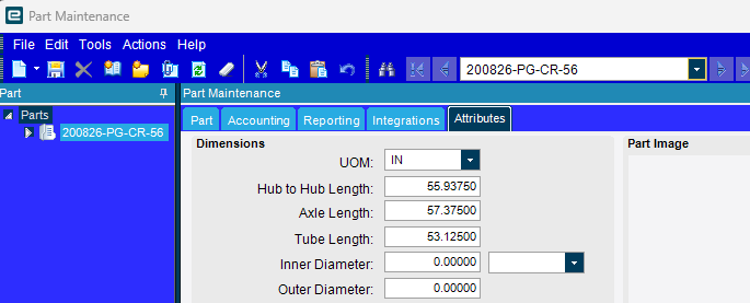

Yes, its a normal part number. We are wanting to use data in the Attributes tab to populate on the job traveler.

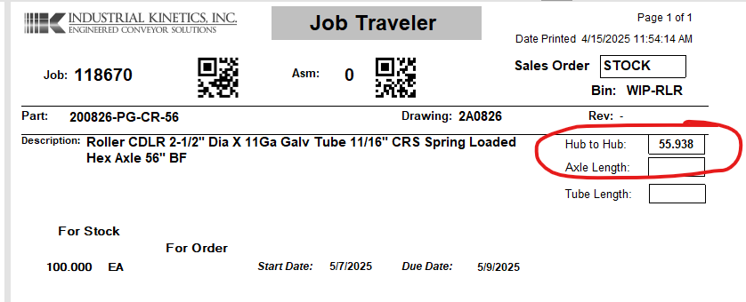

Like I said I can get the field PartLength (which is shown as “Hub to Hub Length”) on the traveler but the other 2 fields keep erroring out.
If I remove the other 2 fields (PartWidth and PartHeight) from the report it runs. If I add either or both of them it gives the error those fields are invalid. I can’t find anything different between the 3 fields.
