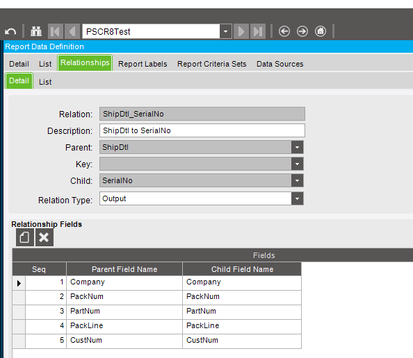

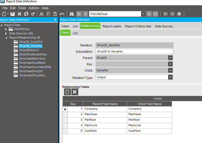

I am working on a Bartender label, but having issues with the data. I took the original PackSlip and brought SerialNo out with a relationship to ShipDtl using PackNum and PackLine and Company.
But it’s creating an issue where instead of 9 labels, it doubles it by making 18. In this particular example, there should only be 9 serial numbers populating.
What can I do to fix this?

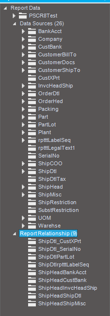

Show your datasources list please.
That looks like the original PS set mostly and the RDL how did you change that for bartender to use? Or rather how are you generating your output for bartender?

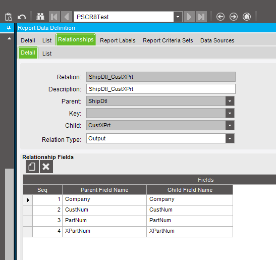

CustXPrt was added/given a relationship and SerialNo was given a relationship. Both to shipDtl.
Plus some un-excluding, but otherwise that is it. It works fine aside from printing double. And when you look at the Record Browser in Bartender, you’ll see double/18 entries for this particular slip I am testing.

So, the original dataset already creates 2 row per one PackLine can generate multiple serial numbers. Looking at our dataset expression for ShipHeadShipDtl, the relationship you are adding is not required. Our dataset does produce 2 records per packslip line with the only difference is a null vs 0 for column AttributSetID. One for the PackSlip and one for the Shipping Label.
="SELECT  ... ALL THE COLUMNS WE NEED ...
 FROM ShipHead_" + Parameters!TableGuid.Value + " T1
 LEFT OUTER JOIN ShipDtl_" + Parameters!TableGuid.Value + " T2
  ON T1.Company = T2.Company AND T1.PackNum = T2.PackNum
 LEFT OUTER JOIN RptLabels_" + Parameters!TableGuid.Value + " T3
  ON T1.RptLanguageID = T3.RptLanguageID
 LEFT OUTER JOIN SerialNo_" + Parameters!TableGuid.Value + " SN
  ON T2.Company = SN.Company AND T2.PartNum = SN.PartNum AND T2.PackNum = SN.PackNum AND T2.PackLine = SN.PackLine"
You should not need the relationship you are creating as the data will be there if not excluded.
