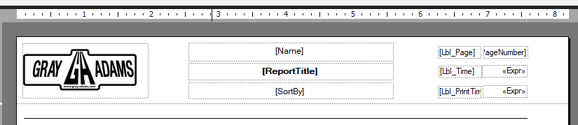

Wow! I deleted the header, still getting 2 pages! There is nothing left in the report. What the heck?!
I rebuilt it again from the ground up with a new BAQ Report and new RDL. Before I added anything to it, I ran the report and it produces 2 pages. I guess this is a sign to just give up.
Try shortening your line on the left to start at 0.1
No luck.
I also tried deleting the line altogether. That didn’t help either.
I feel like since the base report is generating 2 pages before I even add anything to it, it must be a bug with Epicor. I will try to care less and ignore this one for now.
If someone figures it out, please let me know!
Until then, I will submit a ticket that base BAQ reports are generating 2 pages for new reports.

Before I added anything to the report I played with the margins, orientation, width/height until I got it to a single page. Then I added my matrix and it’s working fine.
.2" margins with 8"x10.5" has yet to fail for me ![]()

I have been having the same issue with every single SSRS report I have now resolved it.
I zeroed out the margins and eventually found making sure there is a small space above Name, Page, Pagenumber (in your case) and give it a try - I notice yours are bang along the top edge.
FYI. I tested @briser’s advice above. I confirmed my report still printed blank. I went into the report and set margins to zero and moved header slightly down. It previewed properly. It reset the report and only changed the header. I published and it displayed properly with the adjusted header. I revised the report again removing the adjustment on the header and published. The report now displays as previously with the original margins and header.
I gave up on epicor support. I will just live with this issue until someone else complains loud enough to get it fixed properly.
I don’t move the header down, I just make sure there is at least a tiny gap between the top of the page and any of the items in the header (and similarly the bottom of the footer).
It took me ages to fix this!
You also have a separator line inside your header which starts at the far left of the page, it needs to be moved in a wee bit as well. I have moved mine out of the header to just below and it is a couple of mm in from each page edge.

I’ve had good luck doing this:
- Select “View” in the main menu bar
- Ensure “Properties” is selected
- Click outside your report in the blue background so you can see the Report Properties in the sidebar
- Look for “ConsumeContainerWhitespace” in “Other” properties
- Set to “False”
Hope that Helps!

Just to add I did a test, I made a fresh new copy of a System Style SSRS, did a preview - no blank pages.
I then changed its properties from Letter to A4 (and nothing else), saved it and uploaded - blank pages.
Changing the margins all to 0 got it working but I need to make quite a few changes to the standard report to get it to match what I need so I will do them one at a time to find what breaks it.
