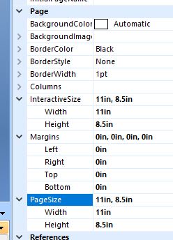

I have 0 margins:

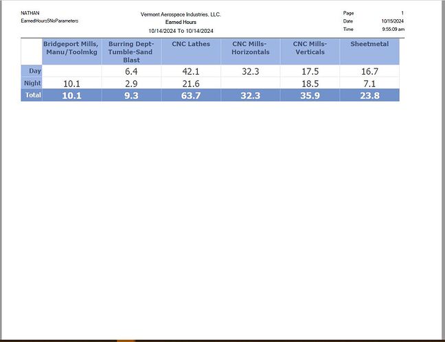

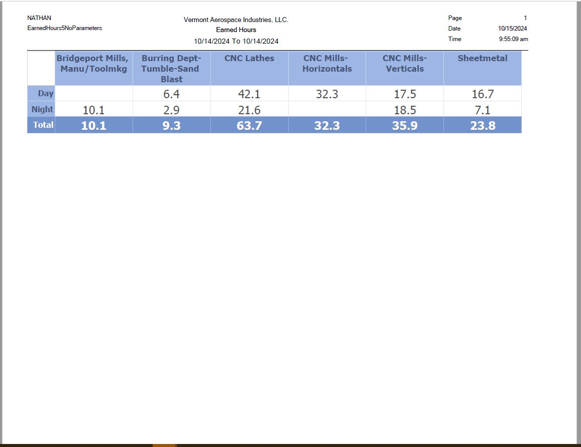

There are only 6 columns in the output and they fit nicely on one page:

Print preview first, then I print it if needed. Second blank page is generated as part of the preview. Yea, I can choose to only print one page, but this is one of those frustratingly difficult things that should be easy. Just trying to get to the bottom of it. I thought I knew how to get rid of blank pages all the time, and I can’t figure this one out!

Same here. I read that one way to get rid of the extra page is to set margins to 0. So, I am taking the brute force approach and trying every option I can find.

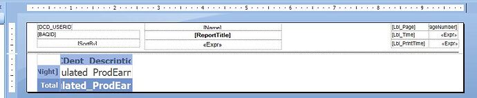

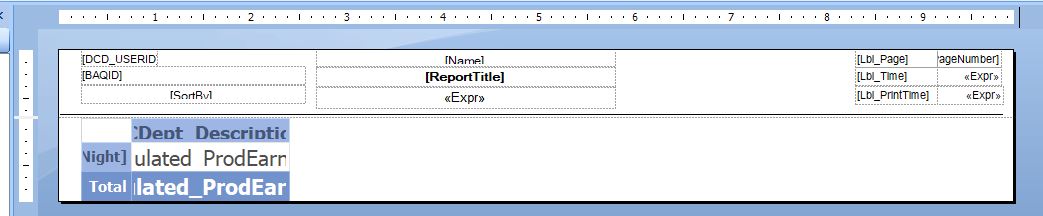

I rebuilt it all from a new BAQReport. Now that I know how I want it setup I didn’t faff around. I just set it up correctly the first time. However, still I am getting a blank second page. I can’t see any good reason for it. Heck, I can’t even see any bad reasons for it! :thinking:
For the laughs, I deleted my tablix. Now there is nothing in my report besides the header. Still getting 2 pages!
