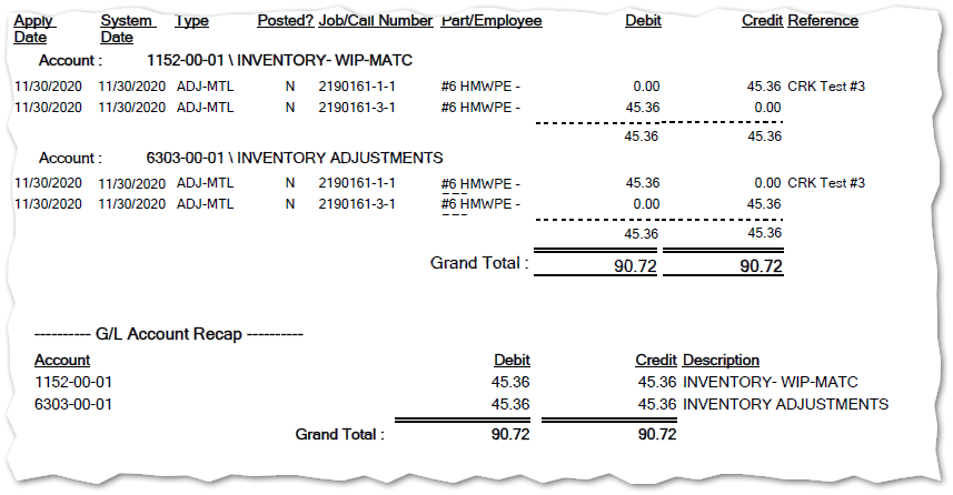

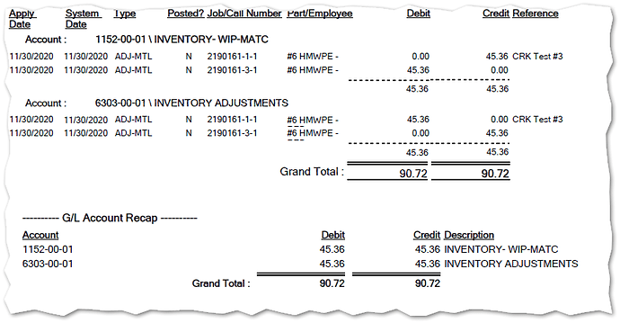

If it has been invoiced (thus preventing you from un-receiving it), you could try using Job Adjustment.
These will create ADJ-MTL transactions, which if done right will exactly offset each other.
And printing the Job Production Detail report will show the transactions and their affect on the job totals
