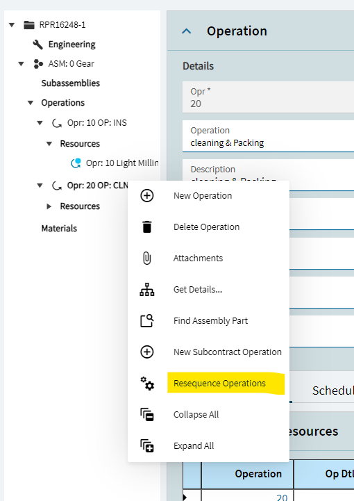

Check the functionality of resequence operations.
I had a look at ‘Resequence Operations’.
It doesn’t let me change the sequence number / order of operations.
What it seems to do is if I have 4 operations in a sequence like this:

It will change them to
10
20
30
40
Going all the way back to 10.0, the only time I’ve been able to change the operation sequence / order has been using Product Configurator Method Rules, and that is during job creation. I’m guessing that probably indicates that it’s intended that way.
