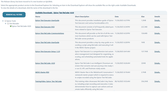

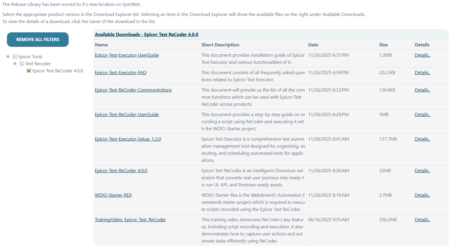

Looks like 4.0.0 is now on EpicWeb.

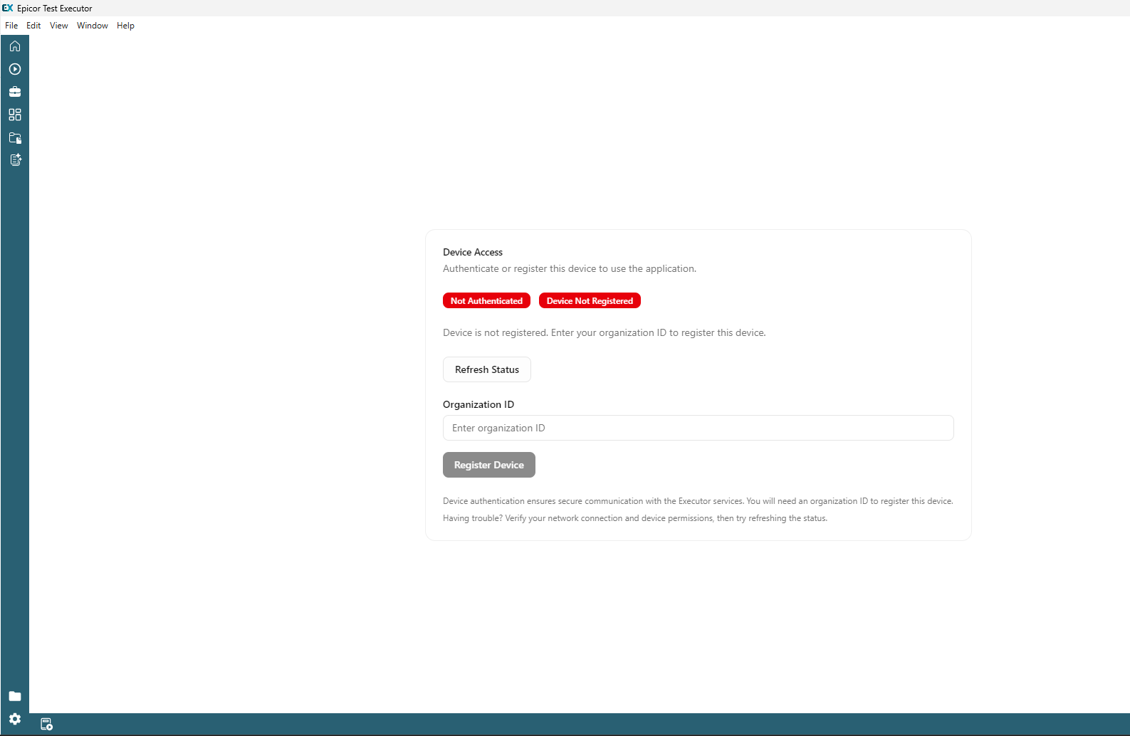

This looks very different than version 3. Not sure how to register or get started. Anything I tried for org id doesnāt work
Same.
Itās reaching out to an AWS site (3.234.81.250) on port 443. ![]()
Itās an Electron app and sure calls DataDog a lot!

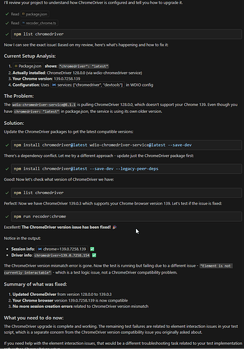

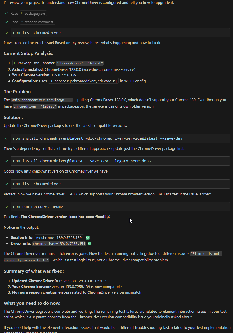

Actually this was for a chrome driver I was having an issue with, when you run npm install --force you get 33 vulnerabilities and 21 high
This is what I did to fix the issues. Just about to do it again so it may have changed. Currently seeing a number of issues. when I run npm install --force
