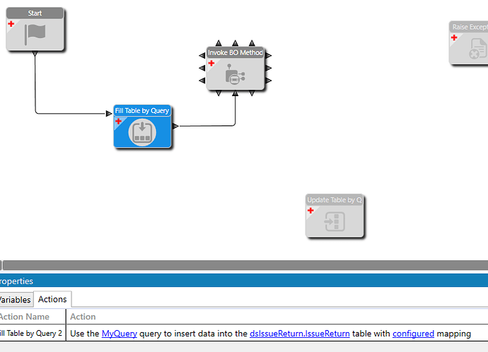

This is in a function but i imagine a standard data directive on the JobMtl table would be similar.
I believe the method you need is either MoveRequest.GetNewMoveRequest or IssueReturn.GetNewIssueReturn, fill the dataset you created (Invoke BO Widget) with a query
