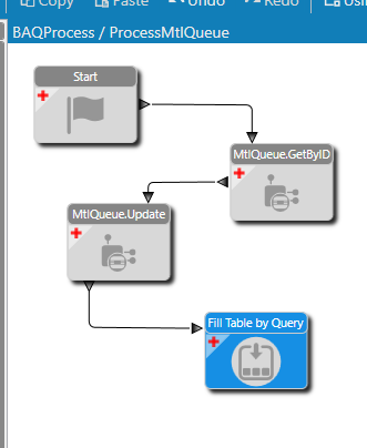

Not sure why this isnt working as i expected… I have another directive doing similar on another table and that works…
The update is tableset is bound to the getbyid variable.
Then i use a fill table by query, pass all the data from the same tableset and change the to Bin and row Mod to U.
a simple bit of code wont update the record…
The correct data is passing into the function as i used an exception to show the 3 variables are available
No errors in event viewer…or in postman when testing the function.
You should probably use the business object instead of the Db context.
If you are dead set on using the Db context though, you need to call:
Db.Validate() in a BPM, or Db.SaveChanges() in a function before txScopeComplete()
In a function, you will also have to enable read/write for that table, and in the tables screen
on the right side, allow edit/update/whatever it says lol.

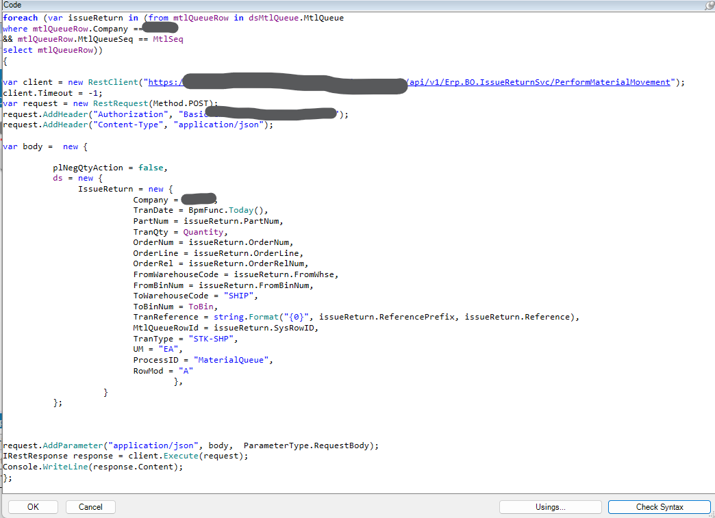

This code works in postman to process a material queue record.
In Epicor however the first line in the body shows an error in event viewer.
The error given is Ice.Api.Exceptions.ApiException: Parameter plNegQtyAction is not found in the input object.
below is the working code in postman, im struggling to find the issue.
No need to call rest from inside.
If you do continue, IssueReturn should be an array.
I know but im struggling with adding a record to the IssueReturns method so i thought id try the rest method as i got that working ouside of epicor.
I understand how you feel. I’ll see if I can futz with it.
what are the long term issues of using rest inside epicor?
