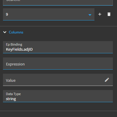

Reading values passed in URL to application
Ended up not working unfortunately -
url

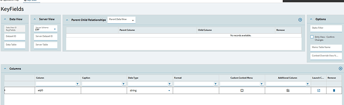

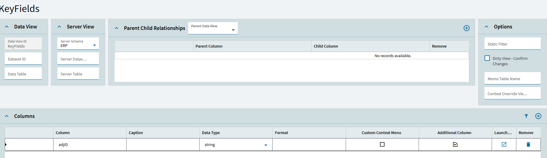

keyfields
keyfields setup

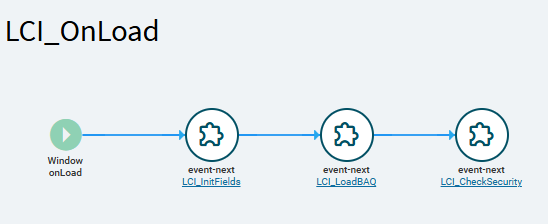

on window load:
LCI_InitFields - onload event
Initialization inside row-update

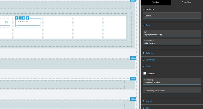

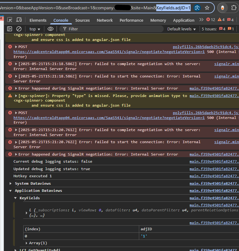

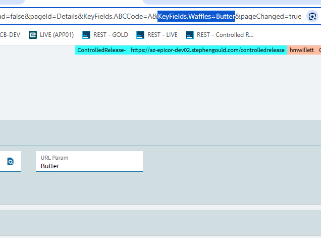

Are you pasting the URL into a new window? Just typing the params in at the top and hitting enter doesn’t always trigger it. The surest way is to open a new tab and paste the whole thing there.
Just did a quick test in my 2025.1 and it worked fine.
Yes - pasting into a new window. I noticed that my page does not even re-load if I changed the URL and hit enter so I have been testing with a new window throughout the process.

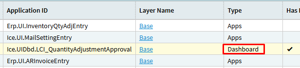

Could this be because I am using a ‘dashboard’ application? Will test in a new ‘Apps’ type application

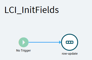

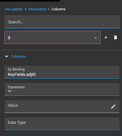

I wonder if your Init event is just overwriting it.
Remove that–you shouldn’t need it for a KeyField, but be sure to check the Key Field checkbox on your control.
Possibly.

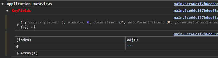

It’s not working in my dashboard either. Stand by.
Not sure what was different… but tried it again from the start and it worked
The only thing I changed was the initialization:
OLD not working:
WOOP WOOP
thank you for all the help!! :smiling_face_with_three_hearts:
KeyFields is the same:
And now -
Gremlins. :woman_shrugging:

Sad to say that our live environment updated to epi 2025 and this has broken :sob:
I’ve set up a event on a control onInit then used the following javascript to query the URL, then consume that field:
“#((() => { const q = window.location.hash.split(‘?’)[1]; return q ? new URLSearchParams(q).get(‘KeyFields.MyField’) || ‘’ : ‘’; })())#”
Just wanted to add onto this post that the working expressions we used is:
new URLSearchParams(window.location.hash.split(‘?’)[1]).get(‘KeyFields.Column’)
