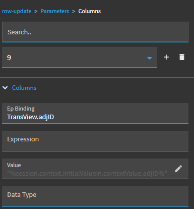

Currently, I have attempted the following:
Value:
"%session.context.initialValueIn.contextValue.adjID%"
However, I am receiving an error:
I have also attempted to create a condition that first checks if the value is ‘undefined’ before trying to update TransView with the value, but I believe that it simply doesn’t recognize the ‘adjID’ context at all.

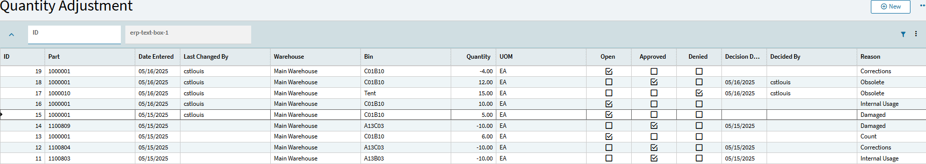

This link does not work for my use-case - I have built this application fully from scratch using UD02.
For example, if I generate this deep link after going to ID 15 manually:
Then the link will not take me to ID 15 in my application - this will take me to the regular landing page of my application:
I am looking to pass the ID within the URL - this ‘share’ button seems to generate just a regular link to the base application.

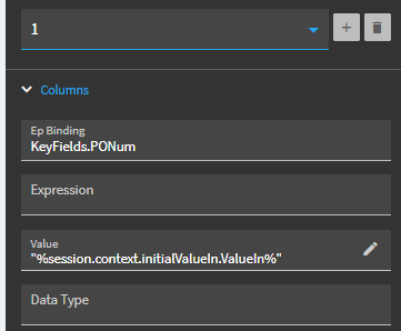

It is a fully custom app so this is definitely the issue - from what I can see from Epicor’s purchase order entry is, for example, they have directly in the URL TransView.PONum=16487
example end of URL:
&site=Main&pageId=Details&KeyFields.PONum=16487%60&pageChanged=true

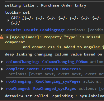

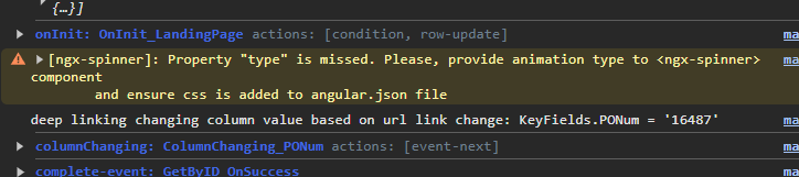

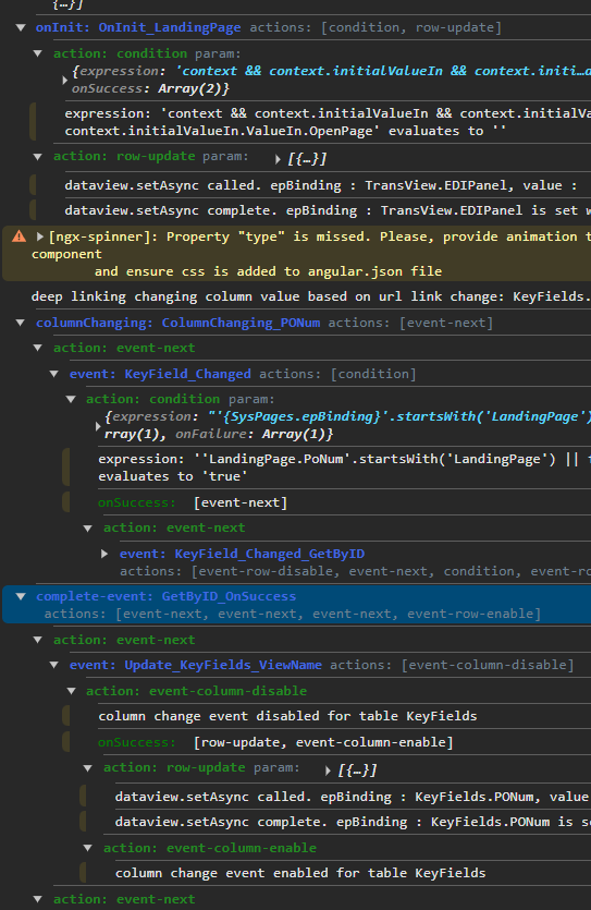

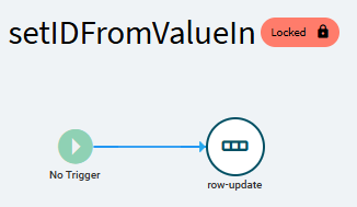

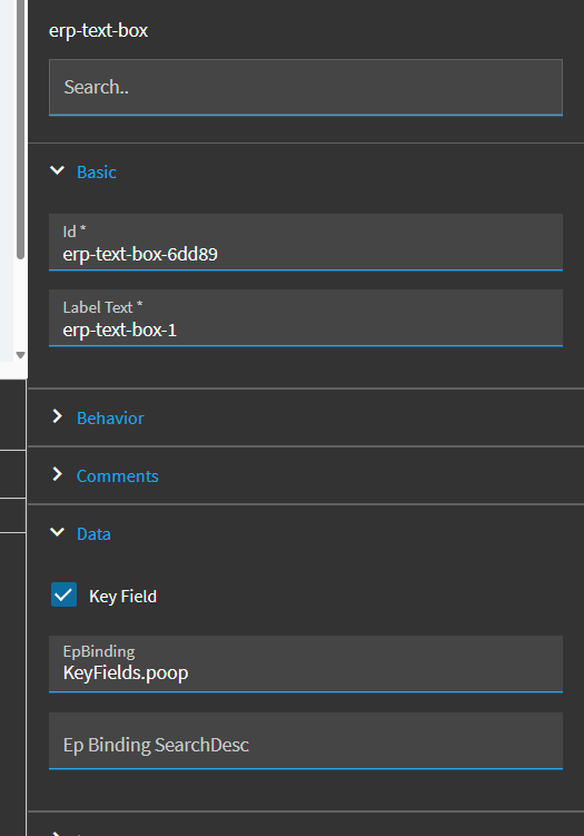

Then, inside the application the only functionality that I could find around this is:
Trying this exact same thing does not work in my application. Additionally, I have tried adding KeyFields the same as them and initializing the value to 0 on_load as they also do this prior to the setIDFromValueIN being called.
Though, after tracing there is no calls to this event whatsoever
Expanded:
To me, it appears as though this value is ‘magically’ being set.

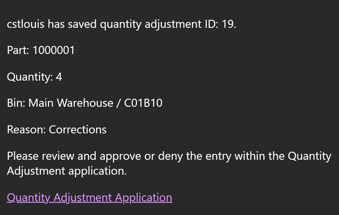

Use-case,
I have a BPM called on post-processing of an update on the UD02 table I am using that to send an email notification:
I would like for this link in the BPM email to carry the ID = 19 over to the application.

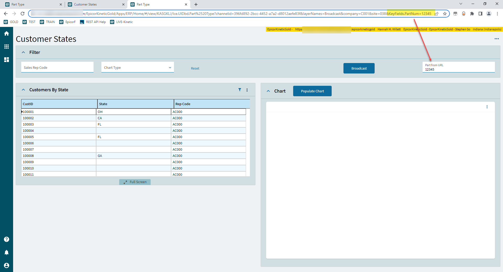

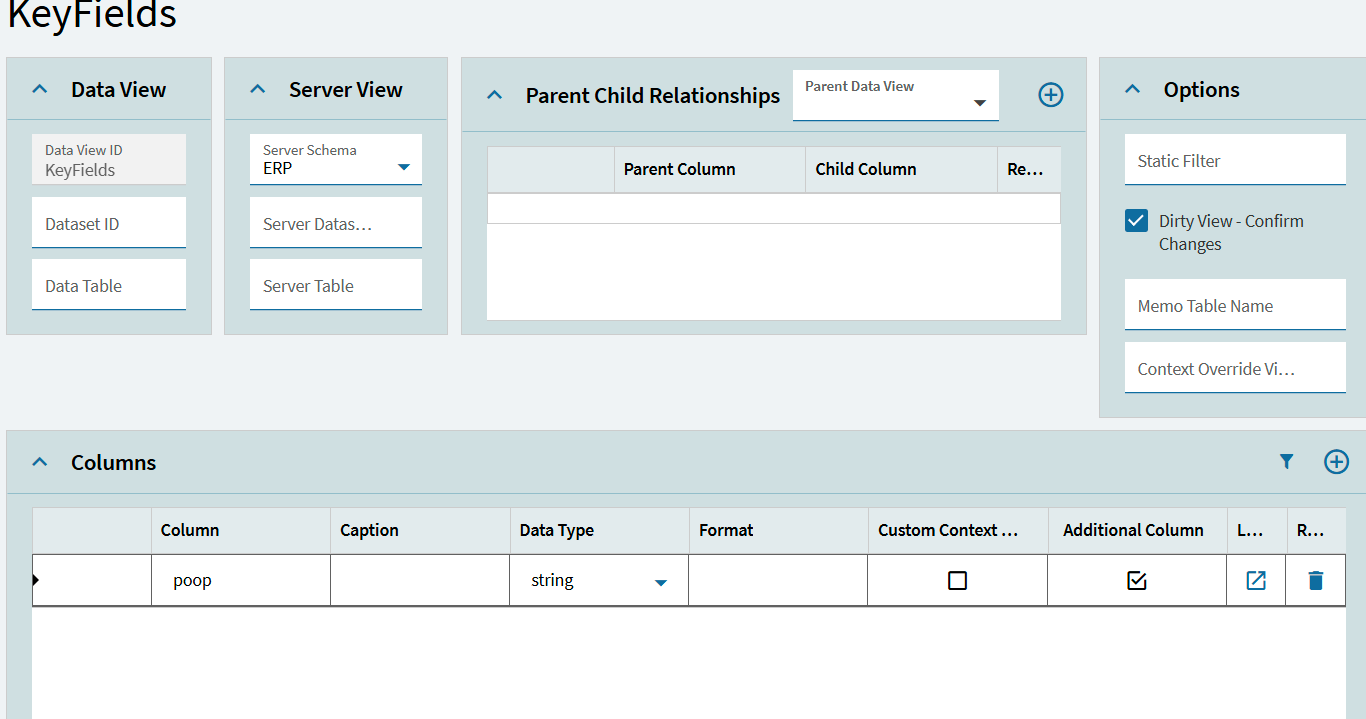

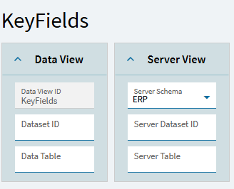

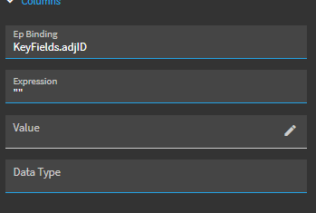

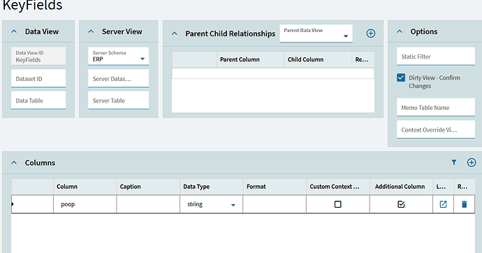

If there is not a dataview called KeyFields, then make one, and add your column.
If it is, just add the column.
If you had to create it from scratch, Initialize it with either after form load, or create an event to on window.onload.
The pic to set it is in that post or here →

On window load:
Data View:

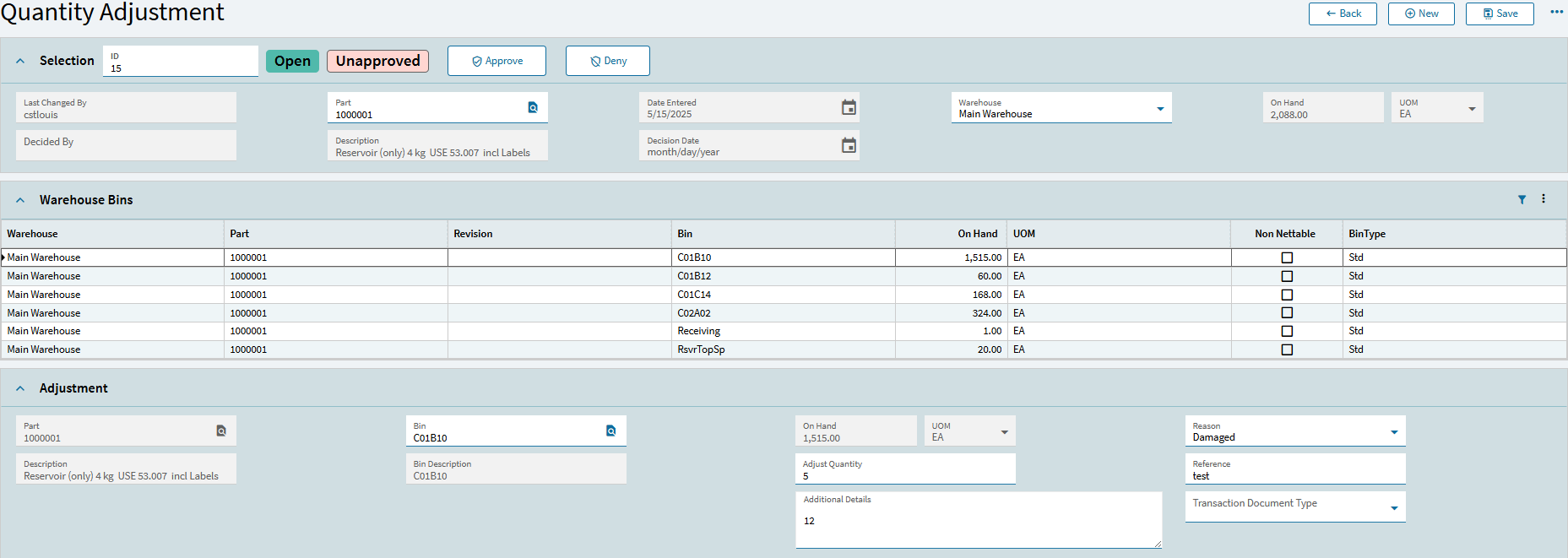

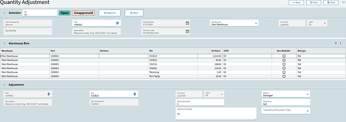

To display for testing:
URL:
Result:
:frowning:

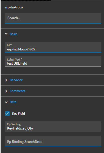

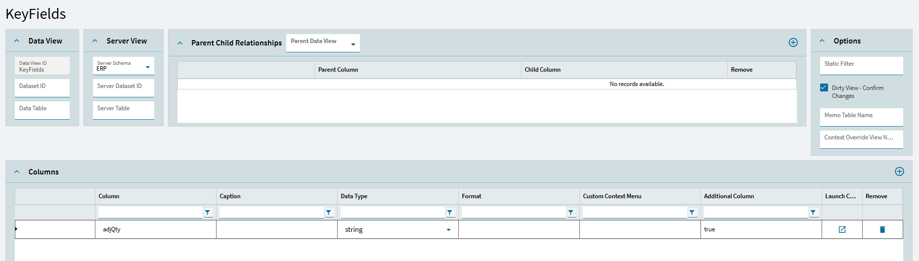

did you add the column to the dataview?
No, dataview is empty.
Copied what was shown in the post but I will attempt with the column added
Apparently, there’s a whole video of me demoing and setting this up out there in the wild. Who knew?
Still nothing
