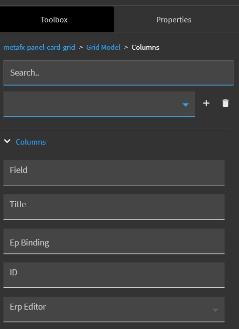

I found a solution. Don’t know if it’s BEST but it does what I need it to, but it’s a pain:
I load the Baq ID in Provider Model and click into Baq Options and set my ‘Where’ clause
I back out to Grid Model and in the Columns I have to manually type each field from the BAQ (SNTran_SerialNumber for example) and then in the Title name it what I want. I created the columns in the order I wanted them displayed in the grid and everything is working fine. It is tedious but it’s there. I used a combination of some info on here and the Application Studio PDF from Epicor to figure it out. Hope this helps!

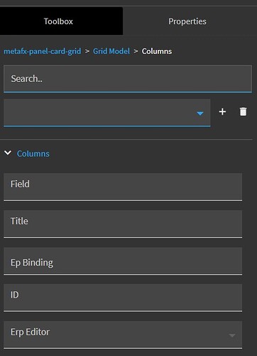

I added a BAQ PCG to my Part Tracker screen and the columns have a mind of their own even after personalizing them. My BAQ field names don’t match the EpiBinding names (i.e. Calculated_TotalDemand). Where in this screen would I put the BAQ field name?
Where is says “Field”. “Title” will be the column header.
Hi Meg,
Have you made a dataview that this BAQ populates? Once you have the dataview, it should have every column in the BAQ in the dataview (Table_Field). Then you can map that Dataview to the PCG and then in the columns you can add each column in the screenshot. Make the field Dataview.Table_Field and rename the title. This is also the way you can rearrange the BAQ fields in the correct order. You will have to do this for every column if you want to change 1. See my previous comment to elaborate that more.
