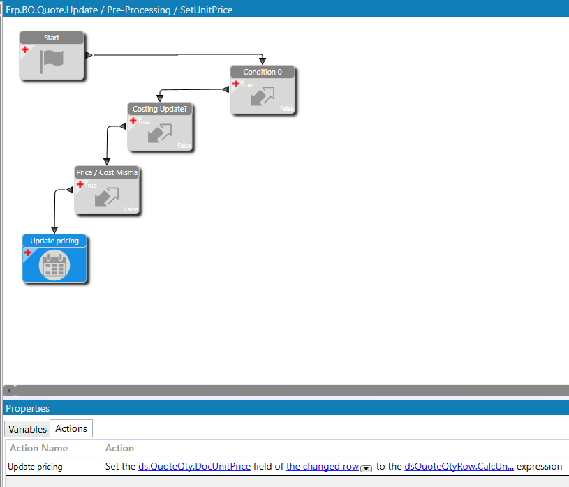

FWIW, quote totals are updating for me when I update dsQuoteQtyRow.DocUnitPrice, in a pre-processing method directive. I’m not doing anything else.
Trying to update dsQuoteQtyRow.UnitPrice, InUnitPrice, DocInUnitPrice, WQUnitPrice had no effect. But setting the DocUnitPrice seems to work, data cascades everywhere else.
