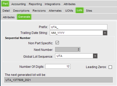

It just doesn’t look to me like the LotNum generating rules are being leveraged here…
vs…

I think you have to click the Next Lot Num button on receipt entry to get that lot number generated as it is set in your screen shot. Try clicking the next lot num button.

When you click the button you will see that the sequenced lot number for that part number increments, regardless of whether you saved the receipt.
I think you could add logic in the generatelotnum method to append the job number to the generated lot number, thus accomplishing your objective.

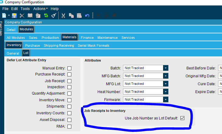

@jfajen
Use Job Number as Lot Default
Select this check box to override the default lot number, if part’s sequential lot number is set to Non Part Specific with an assigned Global Lot Sequence.
If you select this check box and a part (assembly part) entered on a job includes the following Part Maintenance setup:
  • The Non Part Specific check box is selected.
  • The Global Lot Sequence is defined.
then, the job number automatically displays in the Job Receipt to Inventory > Lot field.
Note: You define both Part Maintenance settings on the Part Maintenance > Lots > Generate sheet.
Note: If you clear the Use Job Number as a Lot Default check box, the Job Receipt to Inventory > Lot field displays a global lot sequence value linked to the job assembly part.
Note: To link a global lot sequence value to a part, use the Part Maintenance > Lots > Generate > Global Lot Sequence field
Thanks Prash! I was wondering where that was, totally blanked on the company configuration for lot tracking.
I had a hunch this was probably a setting somewhere. However, I think we’re actually relying on our re-lube Jobs being tied to lots of bearings in this manner. I’m probably going to have to come up with a custom suffix to differentiate the new sub-lots.
So now we’re unearthing a decision made years ago, when none of us worked here, and questioning its merits… good stuff. Thanks for the guidance!
