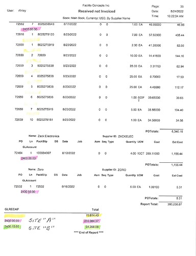

Anyone know what drives the assignment of the GL account # on the actual report RGNI Report?

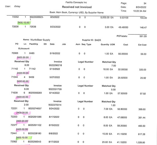

As you can see on the summary page of the attachment, each site has a grand total amount, but there is $70,814.43 which has been received but not linked to an account on the report. In reality the amounts did post to the GL, but the report is not allocating the missing amounts. Therfore the report doesn’t equal the Balance Sheet. I have traced the problem back to Purchase Orders which have line items which have not been received yet. If you look on pg.35, you can see that PO # 72659 is missing lines 8 & 9.
