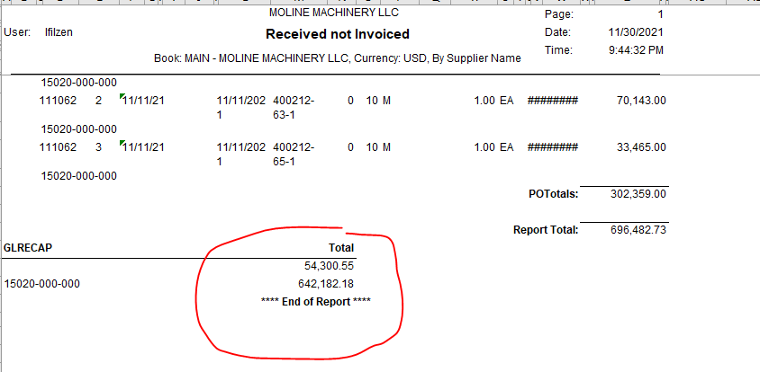

A couple questions on the Received Not Invoiced Report:
  1. Why does our GL Recap at the end of the report show up with 2 line items (image). All of the items received should be hitting GL 15020-000-000 AP Clearing.
  2. Our Received Not Invoiced report does not tie to the GL. They should tie exactly. I have gone through all the steps suggested by Epicor Support and cannot find the issue. Help please! Has anyone had this issue?
  • That total is the amount that has not been captured by WIP. In our case those are items received that day. At our company WIP runs daily late in the evening.

That total is the amount that has not been captured by WIP. In our case those are items received that day. At our company WIP runs daily late in the evening - I run the report at monthend immediately after capturing WIP, so shouldn’t the entire amount be going to AP Clearing in that case since it is all captured?

Are you out of balance by the amount on the report 54,300.55 or is it off by some other amount?
