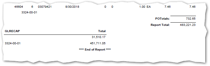

Received Not Invoiced report - incorrect GLrecap
On a new implementation, our Received Not Invoiced report shows an incorrect/incomplete GLrecap at the end. Instead of a regular double-sided entry showing the GL accounts with amounts adding up to the report total, it only shows one half of the entry and the amounts don’t match the report total.
I’ve been working with Support on this for three months (yes, months) without success. Now, even though they can replicate the issue in their test environment, they want me to send them my database. Since they can replicate the issue, this sounds like a code issue, not my data or database.
Is this how the Received Not Invoiced report looks for everyone else?
Any feedback is appreciated!
-Jeff

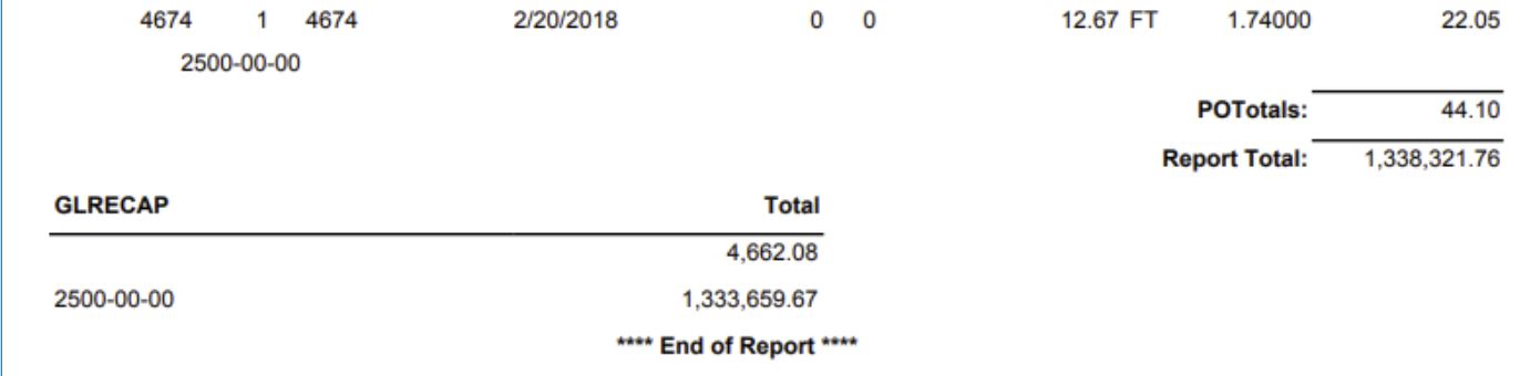

Our looks similar to yours, which is slightly scary to me. But if Accounting is happy, I am happy.
We are on 10.1.400.32
Thanks for the feedback, Lacey! Yes, definitely slightly scary when an accounting report has an unbalanced transaction (the CFO is concerned too). Looks like the amounts in your GLrecap almost add up - off by a penny like ours. Just no idea where the majority of the dollars are going… :frowning:

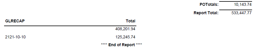

FWIW 10.1.400.23 also looks like that:
