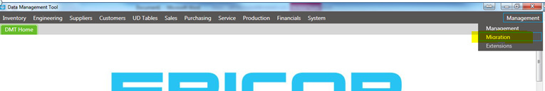

The latest version of DMT has a “migration” mode which lists out Phases 1-5 in the order you need to import records.
The DMT is a great tool to use but I find some modules you will need to go back to finish the Import.
Buyer for example shows up under phase 1 but you cannot complete it until you complete the User import in phase 3.
This is for DMT 4.0.6.0
How do you access this “migration” mode?
Oh wow, look at that. Is there a print out of this somewhere?
