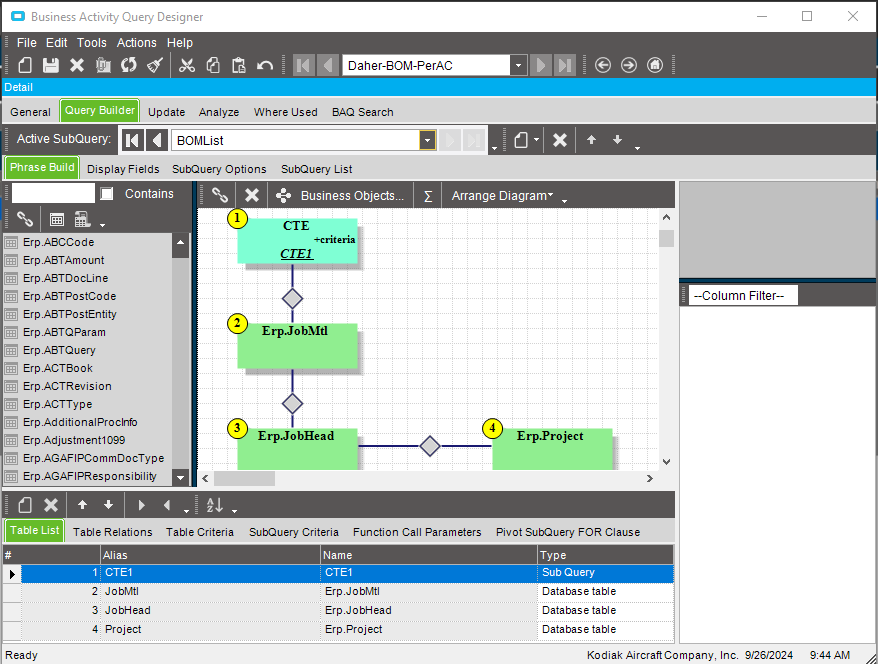

I’m trying to build a CTE BAQ to build a BOM that will show us all the sub assembly parts and then raw materials that are layered in our parts.

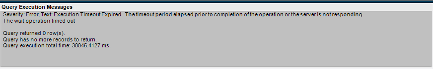

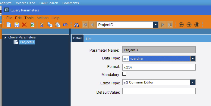

I want the BAQ to pull this data for only the parts on the Jobs listed in Project entry. I set up the parameters for the BAQ to look at ProjectID but it errors out.

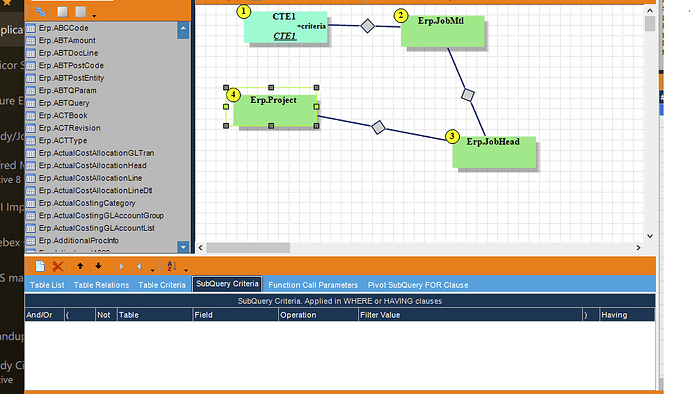

I would consider applying the parameter to the top level part number on the job and then filtering by the ProjectID in a subquery. It would be beneficial to see some screenshots of how you set up the Recursive BOM with the querys.

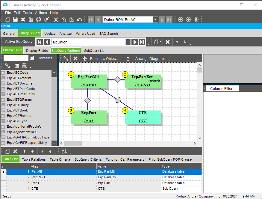

Just curious did you follow the steps on the creating CTE recursive BOM’s that epicor provides?
I did follow the steps for creating a recursive BAQ.

What I would like to write is a BAQ that looks at all the jobs per project ID and use those as the parent part. Then recursively look at all the mtl parts and see what it takes to build those. This can technically go 7 layers deep.
That sounds perfectly doable. I didn’t import the BAQ so I haven’t looked at it, but what error are you getting? Timeout? Bad SQL? does it pass syntax check?

So first thing I see wrong with your query, you created a parameter, but you never actually applied that to anything, so even if everything else is working correctly (which I don’t know for sure yet) that would cause a timeout.

I have the parameter’s linked to Erp.Project again and get the same error. I exported the BAQ before I realized that I need to add those back in. I keep deleting and retrying options to get it to work.

Then this won’t work. You don’t have definitive links from one job to the next. The best you can do is a BOM CTE based on the master tables (partMtl). You can get the starting part number from the parent job, but you’ll have to walk a generic BOM, not job BOM’s.
