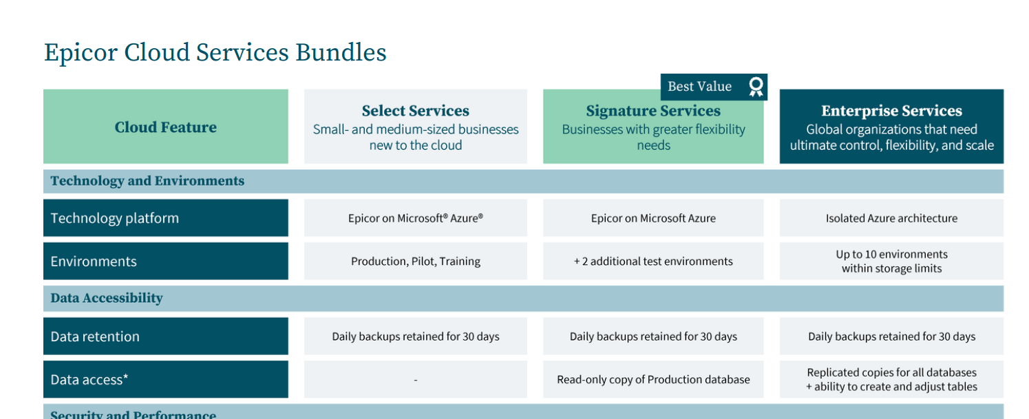

Depending on the tier service you get, the backups are taken fairly regularly like every 30 minutes and RTO/RPO for DR is 8/2 as well. The guidelines I’m following are from the IRS as to what records need to be kept and for how long. We would be housing the historical database on-prem for local users and we have a solid backup solution in place. The cost for the database download is around $1000 per download, so I’m figuring download the oldest of 3 years from the production database and import that into the historical database. The export is provided as a SQL .bak file type.

One thing to keep in mind, at least to my understanding unless something has changed, as a cloud customer, you will not be able to access external data sources. So, you’ll have your data backed-up on an on-prem server, but you may not be able to access/query against it (within Epicor) as a cloud customer.

I’m also curious about this as someone with active use cases for backups. I’ve seen mentions of requesting and receiving database backups as a cloud user, but haven’t had any luck inquiring with support. I don’t expect we could dictate backup frequency and strategy, but I’d like to know what they are.
Just adding it’s not impossible, just can’t do it through external baqs etc.
There are many alternative means to get access to external data in the cloud, we just have to jump through a few more hoops.
